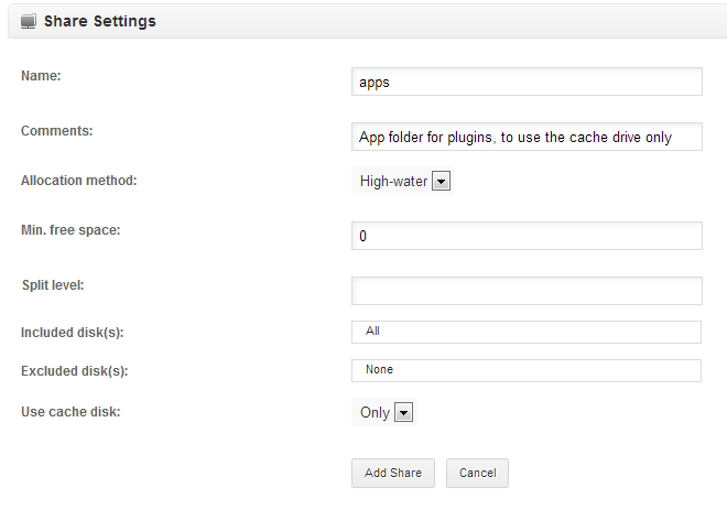

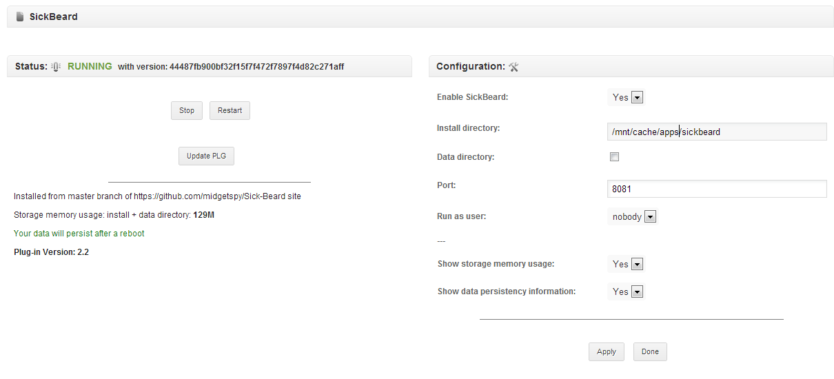

I use Influencer's plugins for Sickbeard, SabNZBd, and Couch Potato v2. Those can be found here: https://github.com/Influencer/UNplugged
  • Install them to your cache drive! You can make a share now that exclusively stays on the cache drive by choosing the option Only in the Use cache disk: drop down
  • I've included a screenshot of this and a screenshot of the install for Sickbeard. The other programs would look the same.

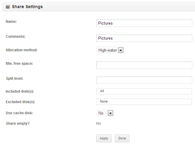

It'd be less complicated to set it up as a cache; none of your shares need to actually *use* the cache, though. See the screenshots I've included and use that as the basis for your shares.
The "apps" share can reside just on your cache drive and be used basically as storage for any additional applications you wish to use. You can set up other shares just like the "Pictures" share I have.
