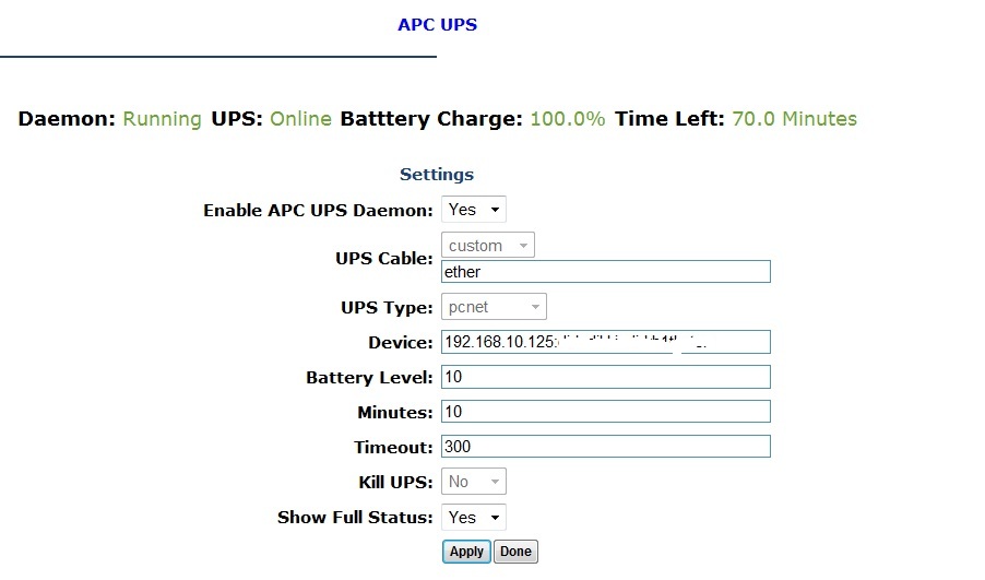

Can a UPS be setup and configured the same in a unraid VM as in baremetal unraid? Or are there special considerations that need to be taken care off? In unraid apcupsd is configured like shown in the attachment. Are these settings about right or need the Battery Level, Minutes and Tmeout be set differently? Unraid might powerdown clean but the ESXi box will drain the batteries and shutdown when the batteries are empty right now. How need things be configured that the unraid VM will autostart after ESXi is started when power comes back?
