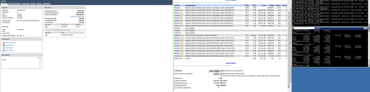

5% Into Parity Check:
Low memory looks good (re-executed free -l in each screenshot as well as ESXi stats on utilization)
Tomorrow I will test spin ups/downs, array shutdowns/restarts
and all other clients and work loads against it.

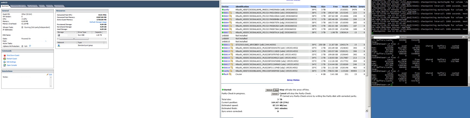

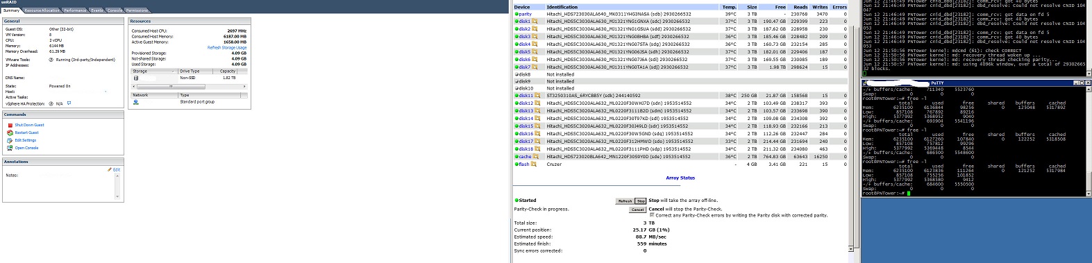

Parity check at 9% (passed that old 250GB drive, now we're moving):
Low mem just fine
