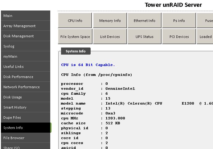

Joe, perhaps you should add that as a separate button in the system info section of unmenu. At least that way people with command line allergies have a quick place to look.

It is already on the "CPU Info" button in the System-Info section of unMENU.  (Have you checked for unMENU updates in the past 5 minutes or so.  The updated version has been there for at least that long.  ;))
