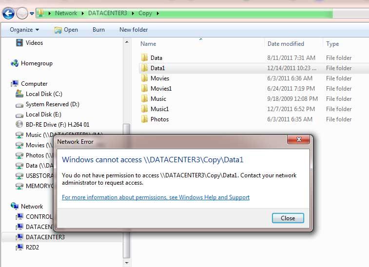

hello everyone.
i installed the plugin today and everything went totally fine!
I can accsess the shared folder and all but there is a problem im having with permissions and ownership of the new mounted drive.
the drive is set to read only and the owner is root:
I want to use the snap mounted HDD as Apps folder for SabNzbd and Sickbeard n such, but every chown or chmod command via telnet is not working.
please can anyboy help me out? its driving me insane....
THX
PS
im using these ...
chmod -R 777 /mnt/disk          for rw perms
and
chown -R nobody:users /mnt/disk        for owner
You have to install the ntfs-3g driver.
The stock ntfs driver is read-only
You can easily install the driver from the unMENU (if installed).
Or search the forum for a standalone version.
sorry: not working:
I didnt mention my FileSystem of the disk. it is ext2. I installed the Ntfs-3g and tried to chmod and chown but no luck.... still the same !
i will format my drive to NTFS to test and check back here a little later!
Thank u so much for the quick help!
