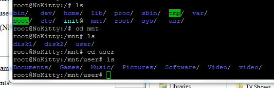

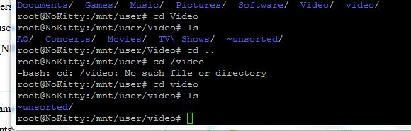

Looks like I have broken a share and I'm not sure how to fix it.
I got SABnzbd running fine but when I was setting up the monitoring folder me not knowing much about linux decided to point it to what I thought was a folder on my Video share.
Of course I typed Video in lower case so now I have;
/mnt/user/Video
/mnt/user/video
All my movies are under the one with the capital but when I browse to it using smb fom my win 7 pc it only sees the lowercase one which just contains a '~unsorted' folder I created.
I have a few TB of movies on there and really don't want to lose them.
If I browse to the /mnt/disk1 I can see both the 'Video' and 'video' folders.
Is there any easy way to fix this? Do I just delete the lowercase one and that will fix the share in windows?
Thanks for you help.
Added some attachments not sure if they will be any help

You can delete the"video" folder, but only if it is empty.
I'd do something like this:
mv /mnt/disk1/video/*  mnt/disk1/Video/
It will move all the files and sub-directories in the lower case directory to the upper case directory.
Then you can just type:
rmdir /mnt/disk1/video
Great thanks, if I do that from /mnt/disk1 will it automatically remove it from /mnt/user as well?
Also is it possible to put a spare drive in the unraid box but don't add it to the array or add it as a cache disk but still be abe to access from windows?
I would prefer to just use a stand alone hard drive for SABnzbd but don't want a cache disk. Or can you not browse to \\tower\disknumber\ if it's not in the array?
/mnt/user is just a virtual unioned view of what is on the /mnt/disk*.  It will automatically be updated to reflect your moves.
