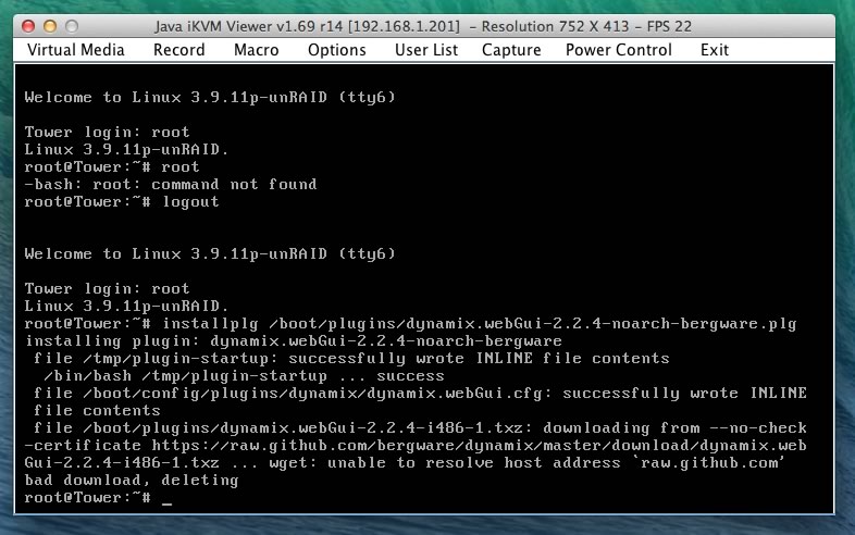

Well I downloaded the package manually and sent it to the flash drive over the smb network and then ran the installplg command and this is what it returned. See Screenshot.
Sounds like unRAID can't get to the internet. Can it ping www.google.com for example?
I don't really know how to do that from the console, but the server is plugged into the router and its connecting to the internet. Its a similar message that I got returned when running the wget command and not manually installing.
The only thing I have not done is add my DNS settings in unraid, it has a fixed IP but I have been trying to find out about the DNA 1 & 2 settings, i.e. is it from my ADSL provider or router or what, this may have something to do with it. But its picking up the UK NTP time server and setting the time okay.
The plugin needs to download that other file. Alternatively, you could download it yourself and put it in /boot/plugins since that is where the plugin will put it when it downloads it.
Ping from linux is the same as from DOS:
ping www.google.com
but it will keep doing it until you do Ctrl-C to stop.
Yes looks like that is the problem as it gives an unknown host reply. I have looked in my router settings and it says use router as DNS server, maybe I should change it and put my internet provider DNS settings in there or leave it as is and put my internet providers DNS settings in unraid webGUI, i.e. the network.cfg script. I don't know and there is very little information in the unraid configuration guide under DNS settings.
Try using these for your DNS addresses on your server.  (They are the ones for google's DNS service.
The Google Public DNS IP addresses (IPv4) are as follows:
    8.8.8.8
    8.8.4.4
Or go to your IPS information page and get the addresses for their servers.
EDIT The reason I am suggesting this as I added DNS addresses to my network setting and there had to be a reason that I did it!!!
Yes I will do that as soon as my drives finish preclearing, about 15 hours to go. As I don't want to affect anything. I have my ISP DNS server setting and can use then, I just wondered why the router is preset at use router as DNS server. Thanks for your help Im sure these settings have something to do with it, I will change them in unraid and on my router.
When I have the dynamic updates turned on, this thrashes my disks.  Is this by design or do I perhaps need to fix a configuration setting somewhere?  I can disable them and my disks are quiet.  I just have to refresh my web browser if I want an update.
I don't doubt this can happen if you don't have a lot of memory in Windows/mac computer and you have a lot of windows open.  In memory stuff that is not active for a period of time will be spooled out to cache memory on your hard disk.  When an update to the webpage comes along, that memory segment has to rolled back in, updated and will probably be rolled back out again in due course.
I would leave the router alone and just add them to the unRAID settings.  That will prevent unRAID from thinking that the  router has already been supplied them. (This will normally happen when unRAID gets the IP address automatically from the router.)
Thrashes the disks in the PC where the web browser is running, or thrashes the disks on your unRAID server?
I setup my ISP DNS server settings in unraid and in my router and its now installed perfect, thanks guys.
