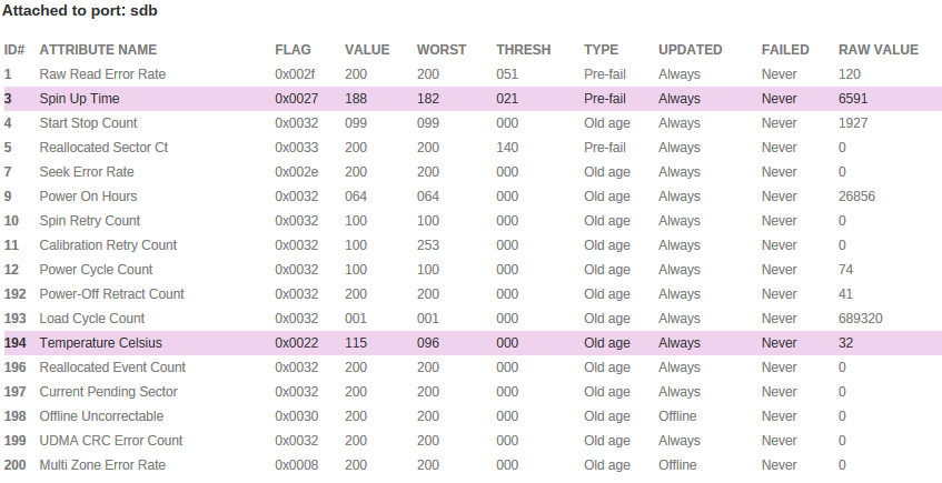

Also, while rummaging, I happened across the attached on one of my older disks. I don't recall seeing a pink highlight on any of these stats before, does that indicate that something's getting close to failure and I should consider retiring the drive before it pops?

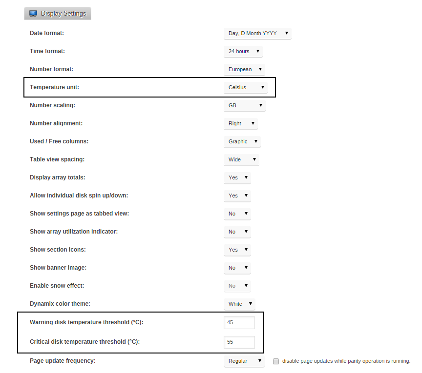

Go to  Settings -> Display Settings
In here you can choose the temperature unit (Celsius or Fahrenheit) and set the appropriate warning and critical disk temperature. See the attachment.
The pink color in the health report is an informative notification, nothing is broken, though SMART considers the particular attribute as an exceeded threshold.

I was looking to see the pop-up that Rudder2 was complaining about, so I set it to a very low 30C. I like the flashing HOT-temp indicator on the dashboard view - much better than the old HOT. I didn't see a pop-up to be cleared anywhere, though, is this a different setting?  His comments seemed to indicate that it could be set on a drive-by-drive basis, so I was looking there, and completely overlooked the Display Settings section.
The drive in question is one of my oldest - running 24/7 in a WinXP machine from 2009-late 2012, then in my unRAID since then. Do you see any values in there to start being concerned about? The drive is roughly 4.5 service years old...
While the color does look pink in that image, I believe it's actually purple, from the following code (from SmartInfo.php):

The first part appears correct, checks for failing attributes.  If VALUE of attribute is lower than THRESH, colors the line red if a critical attribute, or pink if not (which should rarely occur).  The second test is whether VALUE is greater than WORST, and if so, marks the line purple.  I believe this should be removed, as I cannot think of any reason this is necessary, and it's wrong here.  For most attributes, VALUE and WORST slowly drop as the drive ages, but for some attributes, like the temp and error rate attributes, the VALUE will bounce around a lot, rising and falling.  WORST will always remain the lowest that VALUE dropped.  For example, if the drive is very hot, then error rates are probably worse, but once the drive cools down, error rates can improve significantly.  Temps of course go up and down.  (Temps are stored as the complement of the number, typically (but not always) through the formula "100 - temp".  So 36 degrees would show as 64.  This is done so that as temps get worse, increasing their value, their complemented VALUE goes down.)
I had these markings derived from the explanations given about how to read SMART reports (interpretation of thresholds), perhaps I need to review that again.

You can increase the warning and/or alert disk temperature level in settings -> display settings and avoid too many notifications.
