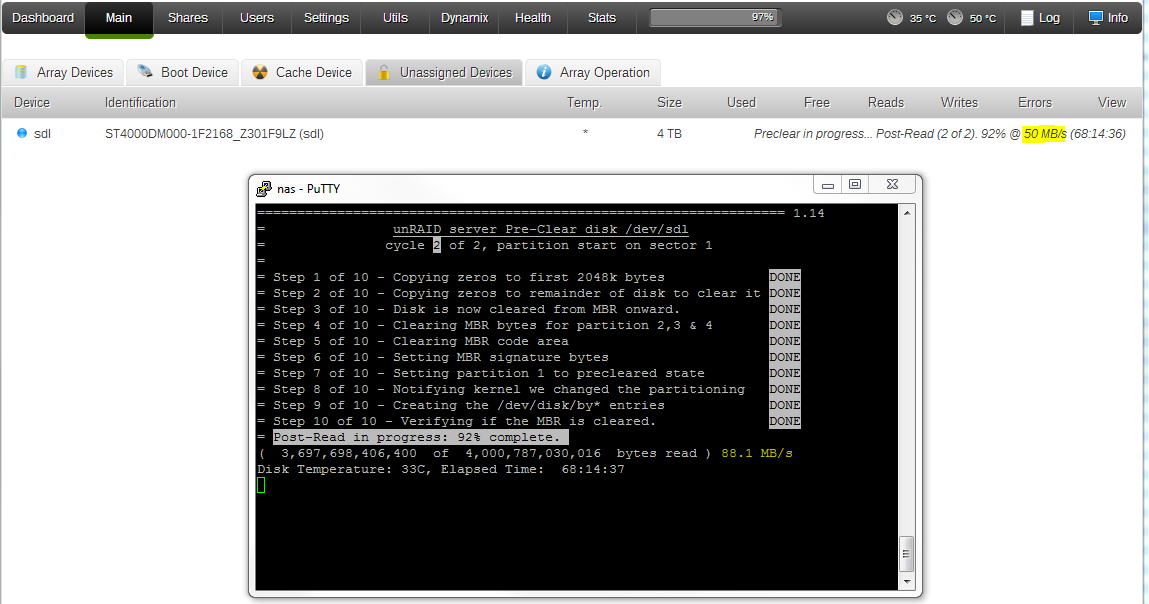

OK, another, admittedly minor, issue.
I'm preclearing a disk using JoeL's script. It reports 92% complete at 88.1 MB/s, but Dynamix's Main | Unassigned Devices is reporting it as 92% 50 MB/s. That's a fairly significant difference in speed being reported.
I'm inclined to believe the script is more accurate, but am open to being shown otherwise. Does Dynamix calculate the speed based on drive size & time? Does it scrape it from a file somewhere that preclear_disk.sh drops somewhere?
Again, not a big issue, but one I've noticed before when running unMenu, so there's something going on.
