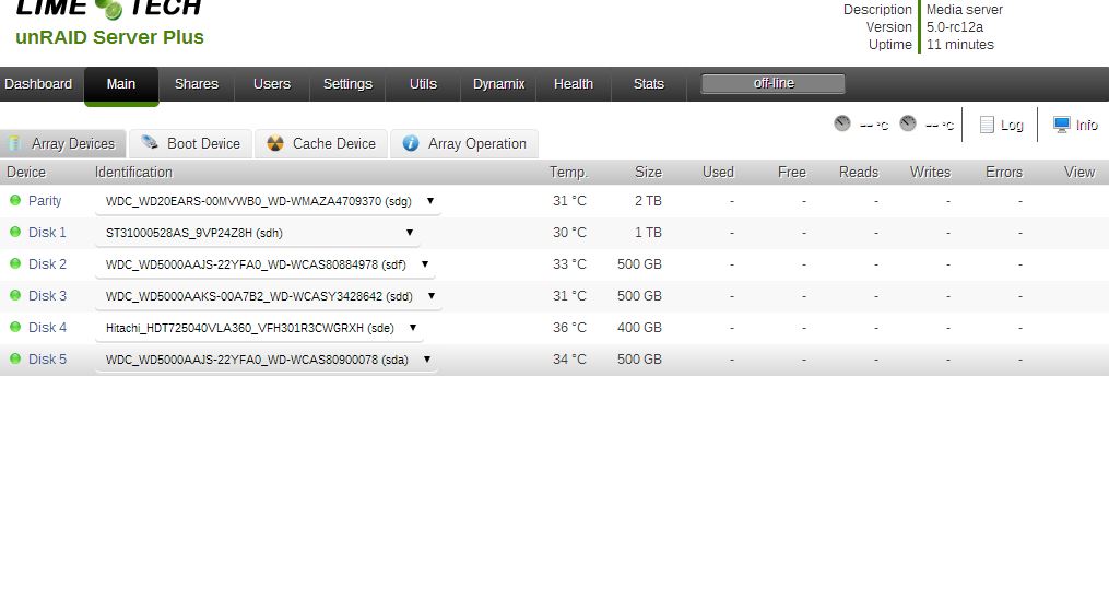

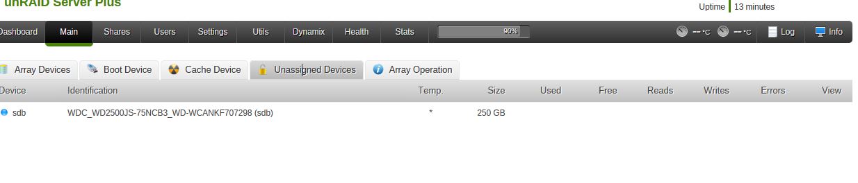

Im a lurker of the forums, but Ive had unraid for about 4+ years now.
I cant figure out how to add a new disk to unraid while using dynamix. I added the drive, booted, and the drive only shows in Unassigned Drives. I Stopped the array, but I cant find an option to add the drive to the array (and preclear). Ive googled every keyword I can think of, and browsed a good portion of the 60+ pages of this thread to no avail.
also.. Is there an easy way to switch to the stock GUI? or does that require uninstallation?
See screen shots attached. I think on my array devices (when stopped) it should show disk 6 and a dropdown to select it. but its not there. Im running dynamix V2.2.7 and unraid 5.0-rc12a.
thanks
thanks
You can't add any more disks to the array because you have an unRAID Plus license. That license allows you 6 array disks including the parity disk. You'll have to jump up to the Pro license to add more disks to the array.
