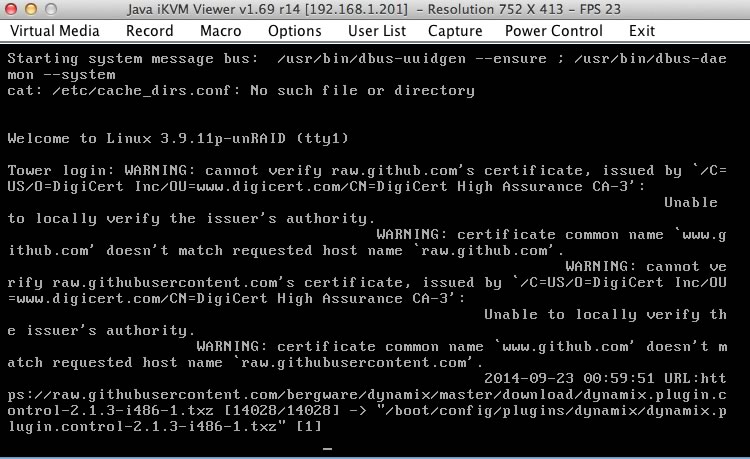

Im still getting errors relating to cache dirs in dynamix. (See post 1050 I this forum) I never had a reply on the cache dirs forum as to the error. Im now getting these errors from Dynamix. See Image.

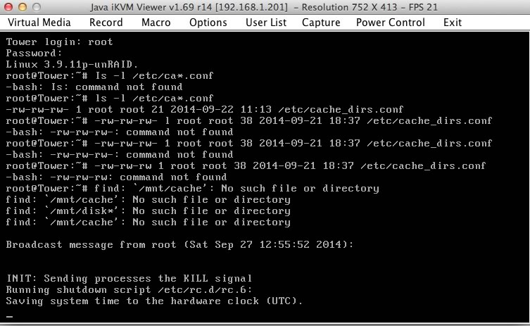

I notice in the cache dirs settings it has default time to scan as 1 sec and 10 sec but nothing in the boxes. I just added a scan depth of 4 and put 1 sec and 10 sec in the boxes but I wonder if this conflicts somehow, is there supposed to be blank boxes on the default settings. I hit the default button and then just added 4 in the scan folder depth and rebooted. I went back into my KVM and captured this just as unRAID starts a reboot. I think the mnt errors are maybe from when I stopped the array prior to a reboot?

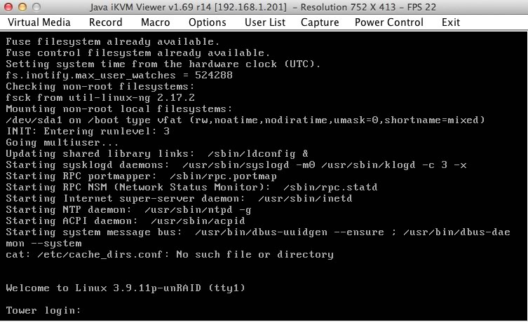

Then after the reboot this is my KVM screen image.

okay but I don't know what the letters are the first one next to the S is it is Is Ls ls what is it and are the other letters an L or a number 1?
I can't do it I keep getting errors as I don't know if line one and two are supposed to be together, if its an L or 1 or i and the spacing. Its just to hard as I can't cut and paste into the kvm.
(lima)(sam)(space)(dash)(lima)
Does that help?
So I removed cache dirs and rebooted. The KVM screen was fine no errors. I re-installed cache dirs and as soon as I enable it in the webgui settings and put a scan depth of 4 in the box and apply it I get this error in the KVM
find: 'mnt/cache' no such file or directory.
Obviously there is a problem with cache dirs loaded from the control panel, maybe other users leave the default scan depth I don't know. I will have to remove it until it is repaired or someone can help me further.
Thanks Johnathanm but I have removed it. Something is broken be it cache dirs or the plugin through control panel.
