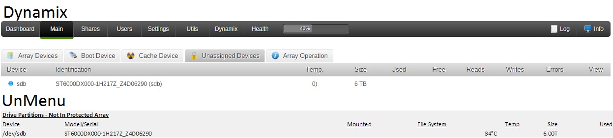

I have a drive not displaying the temp in the Dynamix GUI. It does show up in the UnMenu.
Drive - Seagate Desktop HDD 6TB 6Gb/s 128MB Cache 3.5-Inch Internal Drive Retail Kit (STBD6000100) (http://www.amazon.com/Seagate-Desktop-3-5-Inch-Internal-STBD6000100/dp/B00JBJ34WC/ref=sr_1_1?ie=UTF8&qid=1414374227&sr=8-1&keywords=Seagate+Desktop+HDD+6TB+6Gb%2Fs+128MB+Cache+3.5-Inch+Internal+Drive+Retail+Kit+%28STBD6000100%29)
Any suggestions on how to fix this?
Looks like a happy Cyclops to me, not sure what you're complaining about...
