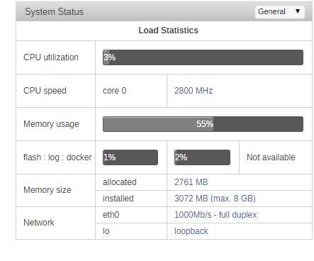

On the Dashboard under System Status, what do you have for flash : log : docker
it says not available for docker, see attached screenshot.
