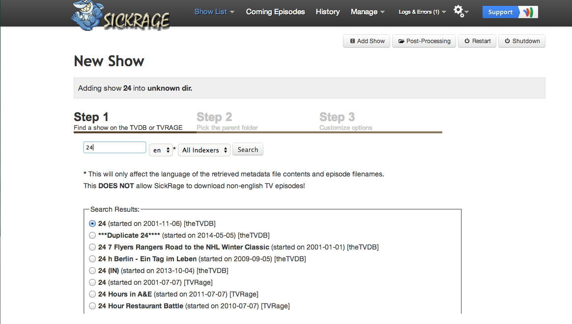

Dockerization of some popular applications.
run command:
docker run -d --name="sickrage" -v /mnt/user/DockerStorage/Sickbeard/data:/config -v /mnt/user/Torrent:/downloads -v /mnt/user/Media/TV:/tv -v /etc/localtime:/etc/localtime:ro -e EDGE=1 -p 8081:8081 needo/sickrage
docker logs sickrage ends with:
10:44:48 INFO::DAILYSEARCHER :: Updating [NyaaTorrents} RSS cache ...
10:44:49 INFO::DAILYSEARCHER :: Searching for coming episodes and 1 weeks worth of previously WANTED episodes ...
10:44:49 INFO::DAILYSEARCHER :: Could not find any needed episodes to search for ...
sickrage logs end with:
2014-07-07 10:45:05 DEBUG    TORNADO :: Searching for Show with searchterm: true blood on Indexer: theTVDB
sickrage browser screeny:
Again, after the message shown in the browser, I have to restart the container (stop/start).
edit: Also, I changed the indexer timeout to 30 to see if that changes anything and it does not.
I am trying to use your sickrage docker and I'm having issues where it can't reach out to tvdb or tvrage. I am using EDGE=1 and verified it's using the latest commit from sickrage master. I can perform the same apt commands and grab the latest zip in a virtual machine and it works. Any ideas?
What docker run command are you running and what does...
say?
say?
run command:
Needo,
I'm still trying to nail down this issue. So far, I have tried looking up a show in the following:
  • Building needo/sickrage on another machine. This worked with some small modifications (needed to install virtualenv via pip).
  • Building needo/sickbeard on unraid machine. This worked, no changes.
  • Building needo/sickrage on unraid machine, both EDGE=0 and EDGE=1. Neither of these worked.
I am clueless why sickrage will not pull from tvdb or tvrage.  Anything else I can try?
I installed a fresh copy of sickrage tonight and I am unable to duplicate the issue...
I do not know why this is not working for you.
