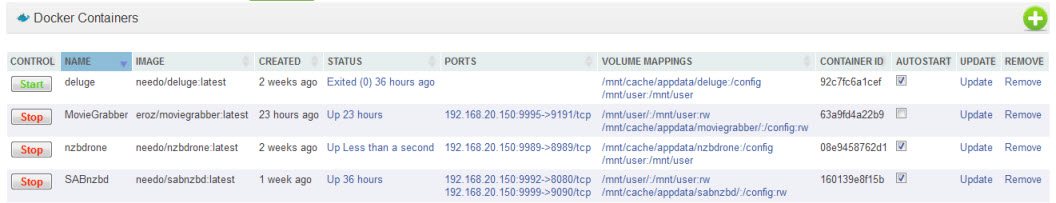

Okay, so you have installed the docker plugin, good.
When you use the plugin, it should show any/all containers you have installed.  See the screenshots attached.

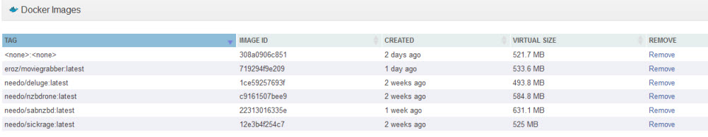

The plugin allows you to remove any/all containers and images.  I suggest you do this.  remove everything you see in either of those lists, and start from scratch.
I would also suggest you remove any folders in /mnt/cache/appdir in case they have weird permissions from anything you've done prior to this.
Once you have no containers and no images, click the green plus sign, select the couchpotato template, make any changes you NEED to make, but leave as much at the defaults as you can.  This should at least get your couchpotato running then you can make any changes you want after you get it all working.
