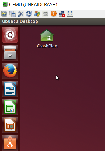

So - I don't think this is a crashplan docker problem - but does anybody know how to identify where this x11vnc process came from so I can kill it and let crashplan run in host mode?
Is there a way to identify what processes are being used by each container?
Can you stop your other dockers and vms one at a time until this one starts without error?  Curious to know what the conflict is, hopefully there is a work around.
Figured out the conflict - but I don't know how to resolve..  Sparklyballs' MythTv container is where the VNC server is coming from.
http://lime-technology.com/forum/index.php?topic=41110.0
I'm able to RDP into that container on port 3389 to a desktop of some sort, I don't know if there is a VNC component to that connection.  MythTv is currently in host networking and is working well, and I hate to break it if it's working. But I'll try changing it to bridge and mapping in all the ports (the MythTv dockerfile has this:EXPOSE 3310 3389 5000/udp 5002/udp 5004/udp 6543 6544 6760 65001 65001/udp )
I'm not sure if MythTv will have a similar issue of detecting the wrong IP. I know there's something in the MythTv backend setup where you set an IP - This will have to be verified.
I'm also going to try crashplan in bridged mode with the ports and see what happens.  I'll watch my router and see where the traffic goes. My original comment
reports the IP as the 172.something of the bridged network, causing it to use the external/public address since it thinks it isn't local
is an assumption, not based on any facts as of yet..
Or if somebody knows how to contact sparklyballs and ask him if vnc can be changed/removed, that would help too.
Any progress on working around this conflict?  ---EDIT--- Turns out I can just stop Mythtv docker (when it's not being used) then the WEBUI for Crashplan works.  When done config, restart Mythtv.  I'm pretty sure crashplan continues to run, it's just the UI that's having the conflict with Mythtv.
