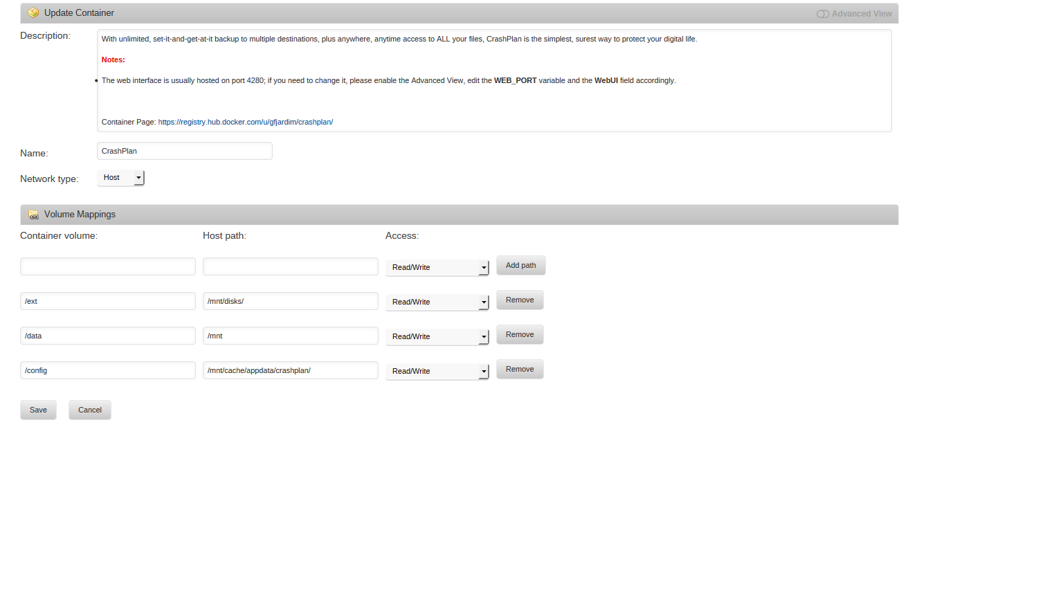

Crashplan not able to backup to external devices (USB drives) or Network shares.
Crashplan always stops at 16GB written, but nothing is actually written to any disks or shares.  It tells me that there is insufficient space on the drive.  My memory usage seems to increase to around 62% and I am running a server with 32GB of RAM.
Is it possible that Crashplan is writing to RAM and not the external disks or shares?  The docker image usage shows about 33GB of space remaining, so I'm thinking it's not being written there.
Here is my docker setup:
Thank you!
You need to map /data to somewhere on your array... like /mnt/user/data and the same would go for /ext whatever that is for /mnt/user/ext/
