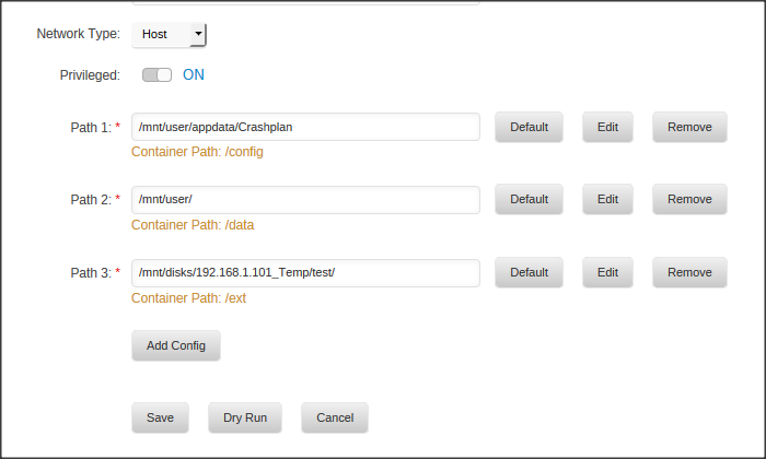

I'm stuck with this question "Q) Why is Crashplan storing backups in my docker.img?", ive tried the steps suggested and its still backing up to the image i have mounted an smb share of another nas using unassigned devices... please help
Kind Regards
Ryan
It could be that the folder mappings for the container are incorrect. Another reason is the fact that you are using the plugin Unassigned Devices to connect to a remote server.
When you start your server the Docker containers (and CrashPlan) are started before the plugin Unassigned Devices has been started and mounted the remote server. This makes your remote server invisible for CrashPlan.
Go to Main (unRAID GUI) and Unassigned Devices and click on the Mount point entry and make sure that you can see the folder on the remote server and its content.
If that works, use the CrashPlan GUI and select Destinations and browse for the destination folder and see if you can see it here as well.
It would be useful to see your folder mappings for CrashPlan. I have included the settings for my configuration.

Dockers cannot see anything that was mounted after the docker service starts. Go to Settings - Docker and stop then restart the docker service after you mount anything with Unassigned Devices if you need any docker to see it.
