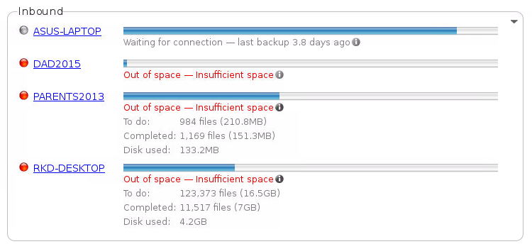

Hi all,
Trying to backup several PC's to unraid but I am getting an error that says "out of space - Insufficient space"
I know there is enough space on this share.
It sounds like your backups are being stored in the docker.img instead of your array.  Review the first post in this thread for help setting it up.

Hi all,
I reviewed it, I thought I had it setup correctly.. I tried to start over and am getting "backup location is not accessible" error
I created a new share called "CrashplanTower" and started getting that error, i went back to the old share, and am Still getting the error.
Where does your "default backup archive location" point?
Did you see my screenshots?
The default location only affects new backups. You might have to change the location for the existing backups manually. I'm not in front of a computer so I can't double check right now.
