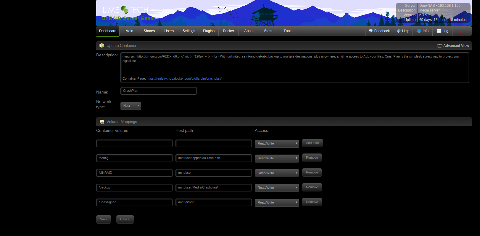

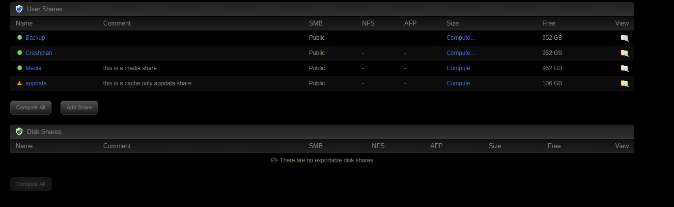

Clearly, I've made a mistake, and I only seem to have made it worse by trying to fix it.
I installed the CP docker and everything worked great. I adopted my old backup (that was running on my Win machine for about 2 years) with about 1.4TB of data backed up to Code42's cloud. I followed their instructions to select my new locations and it was happily scanning along until I received 'Docker.img full' errors.
Re-reading the OP and looking at the details of my install, I realized I had installed /config <-> /mnt/user/appdata/CrashPlan instead of /mnt/cache/appdata/CrashPlan.
I stopped the docker, changed the mapping of /config and restarted the docker, confident that I had everything fixed. After a minute or two, I got a nice green pop-up telling me that my docker.img file use was back below 75% (it's at 30ish% right now). I'm on it, I've got this, no problem!
I returned to the CrashPlan tab in Firefox, hit F5, and nothing. The No VPN page came up, but it wouldn't connect.

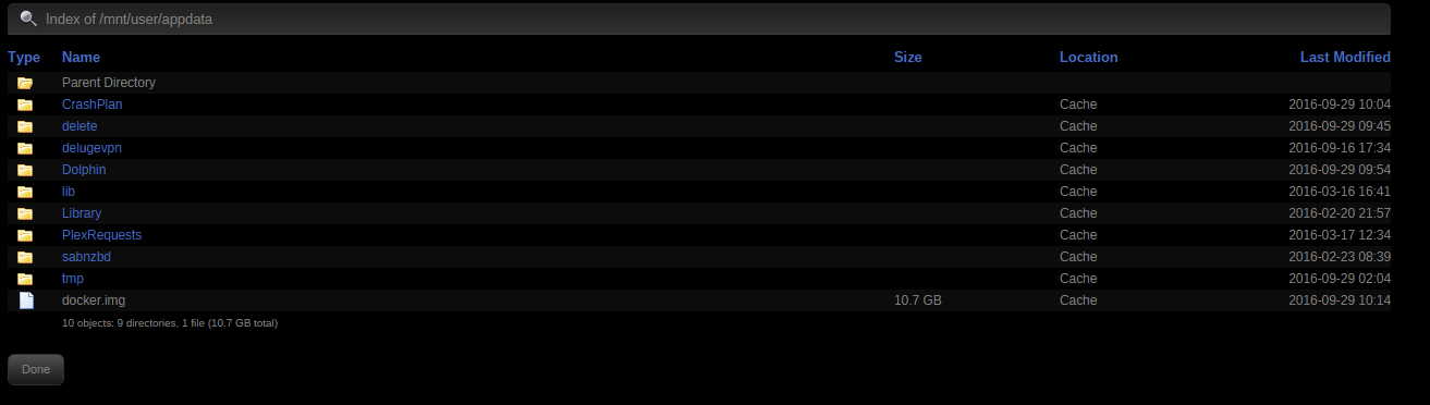

I went to the docker tab in my unRAID management window, and I saw this:
Great. What have I broken... Wait, that makes sense, there's a docker image on /mnt/user/appdata, and nothing's pointed at it - how do I delete the sucker? I clicked the disk icon, and got the 'Remove' option and clicked that, hit 'Just do it'
I got the confirmation message:
Fantastic, job done! I closed out the pop up, and there was that pesky orphaned image icon. OK, we'll go to the 'Dashboard' view, then back to 'Docker', and it'll be gone. Nope, no such luck. OK, maybe this will actually take a couple of minutes, let's go reinstall the docker in the mean time and everything will be great.
I wandered off to the Community Applications tab, selected the 'Backups' department, clicked on the CrashPlan icon again, made sure to specify /config <-> /mnt/cache/appdata/CrashPlan, and hit Done. It went through its install routine, I headed over to the 'Docker' tab, and... yup, the orphan image icon is still there and there's no sign of the CrashPlan docker to be found.
After several attempts to Remove the orphan, all with the same result, I attempted to install the docker to the original /config <-> /mnt/user/appdata/CrashPlan location in the hopes that unRAID would somehow reattach the docker to that orphan image so I could uninstall the docker correctly & get rid of it. That hasn't worked either.
TL;DR - how the heck do I remove this orphan image and get your lovely CrashPlan docker to reinstall itself?

And... that didn't seem to have helped. I'm obviously setting something up incorrectly, but for the life of me, I'm not seeing the issue. I reinstalled CP, got it started and it filled up my docker.img file within minutes.
Here is a screen shot of how I've got the drives mapped.
where have I gone wrong?

I'm not sure what that error code means :) but once your docker.img has filled up, nothing works right.  I'd delete your CP docker at a minimum, and consider deleting/recreating the docker.img again.
I don't know of any reason why backing up unraid to the cloud would fill up your docker.img, but incoming backups definitely will if CP hasn't been configured.
It sounds like the incoming backups are starting automatically?  In that case you should go to those other computers and shut them off or disable backups until you can get CP on unraid configured.
For me, it is easier when I can reference /mnt/user/[whatever] inside the container, the same as I would outside the container, so I would map /mnt/user/Backup to /mnt/user/Backup (doesn't matter whether you use capital or lowercase 'b', with or without the 's', as long as you are consistent).
Once you're happy with the mapping and the container starts again, and you are sure there are no incoming backups :) try backing up unraid to the cloud.  You should see various files added to /mnt/cache/appdata/CrashPlan.  Keep an eye on your docker.img and be sure it doesn't fill up.
Then look for the "Default backup archive location" in the CP settings and set it to /mnt/user/Backup (or whatever directory you mapped) as described in the first post.  Also set the default location for each friend as described in the first post.  At this point it should be safe to turn on the other computers and have them start backing up.  Confirm that files are going to /mnt/user/Backup and your docker.img is not filling up.

I definitely messed up my paths as I just went into my shares and now I have "Backup" and "CrashPlan" in there. I want my backups to go into /user/media/Crashplan
Also, how can I get rid of those two shares that I accidentally created? I can't do it via windows. Edit: I remembered how to delete the shares since they were empty
