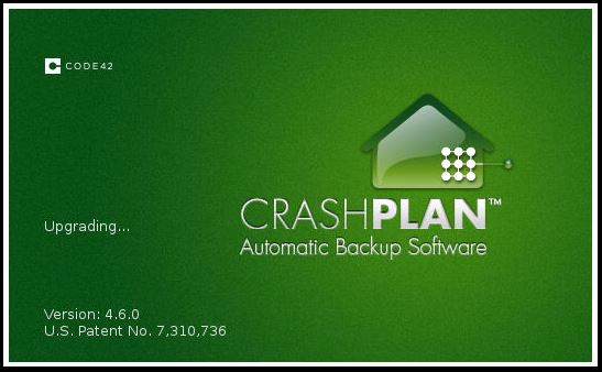

As of this morning, both of my crashplan containers are stuck on "upgrading"
In the webgui, I see the green crashplan splashscreen that says "upgrading" and that's it. Is everyone else getting the same?
Thanks
EDIT: Never mind. After waiting for a long time, it updated and the webgui came up.
Thanks
So update is working, right?

Yes, it did, but took a long time and I thought it had crashed

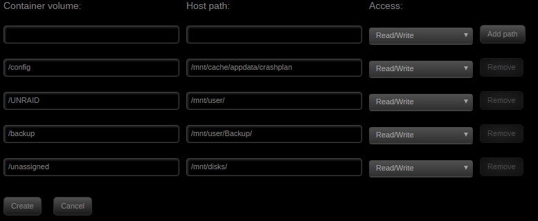

I'm having an issue that I see reported by other users on this thread, but I don't see any resolution.
I'm going to have a friend host a drive for me as remote backup and want to seed the drive (external USB) with data before setting it up at his place. I connect it and mount with unassigned devices. I have the paths set correctly in the docker setup (/unassigned -> /mnt/disks/) and it seems like it is setup correctly as it sees the drive.
However, when I start the backup it runs out of space at about 4GB even though the drive has nearly 1TB free. I also can browse the drive in the terminal and don't see the folder that Crashplan has created. So it must be backing up somewhere else.
Here's where it gets weird. I removed the docker container and unmount the drive, then take a look at /mnt/disks/ again, and the folder that the drive is mounted to is still there. Then when I look in that folder, I see the folder that Crashplan created and was backing up to. If I mount the drive again then I see the first version of the folder (which I think is the physical drive). So it seems like Crashplan is behaving as if the drive isn't mounted and just writing to a regular folder instead of the drive. Like there are duplicates or something.
Any idea what's happening here and how I can fix it? Also, I assume this data is being written to the flash drive right? The UNRAID dashboard doesn't show the usage on the flash drive growing.

It looks like you are backuping in the docker image and its filled up.
Can you show a screenshot of your crashplan docker settings and your crashplan application backup destination?
Sent from my SGH-I337M using Tapatalk
Thanks for the response. I don't think it's writing to the docker image because of the folder that I see at /mnt/disks/, which isn't mapped to a drive but is just a regular folder with the Crashplan data in it.
My docker settings are attached. I need to head to work and don't have Crashplan running at the moment (I removed it while troubleshooting), but I was backing up to a folder on the USB drive (supposedly) that only showed up after mounting with unassigned devices. I browsed to it via /unassigned.
It seems like the Crashplan docker saw the mounted drive and then for some reason created a folder with the same name rather than writing to the drive itself. Not sure if it matters, but the drive is vfat.
No dockers can see anything that was mounted after the docker service was started. Go to Settings - Docker and stop the docker service then restart it so all dockers can see the new mount.
Thanks trurl. That seems to have solved it. I figured it was probably something basic that I was overlooking.
