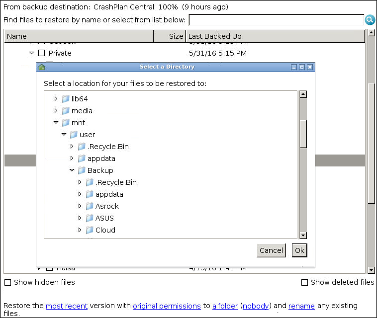

I just lost a drive; For some reason it forgot a superblock or something and didn't want to mount. Stupid me formatted it in Unraid when it also detected it couldn't mount it (instead of removing it first). There goes 1 TB data.
I'm now restoring from Crash Plan, but it just informed me that I don't have enough disk space? Does crashplan copy the restore from the web to it's own Docker container first and then push it to the array? How can I make the restore happen directly to the drives?
You can restore to another share or folder. Go to Restore and select "a folder" then click "nobody" and browse for the location you prefer.
