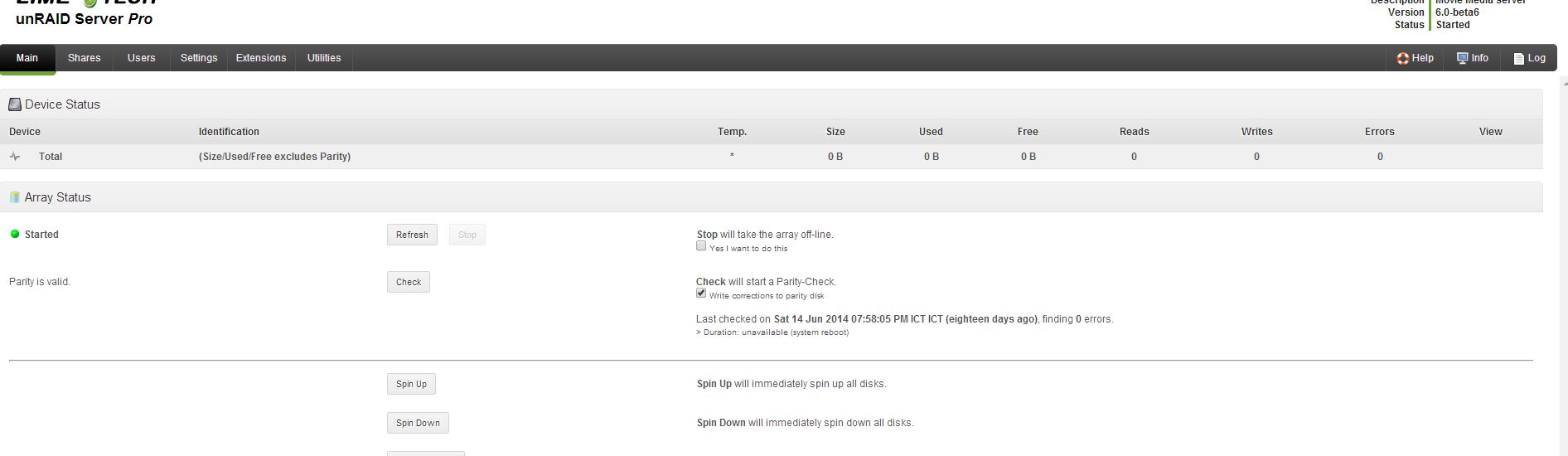

anybody tried a reboot with this installed ?
I get attached screenshot after a reboot ....
seems i lost my stats somewhere
funny thing is that everything else works .. wife is watching a movie as i type :P
rebooted a couple of times with this installed - no issues yet, I initially had both the startup.plg and dockerman.plg installed, but removed startup.plg
OK Thanks
rebooted while the wife was on the phone and all good....
not sure what caused it ... will reboot a few more times today between non busy times :P
