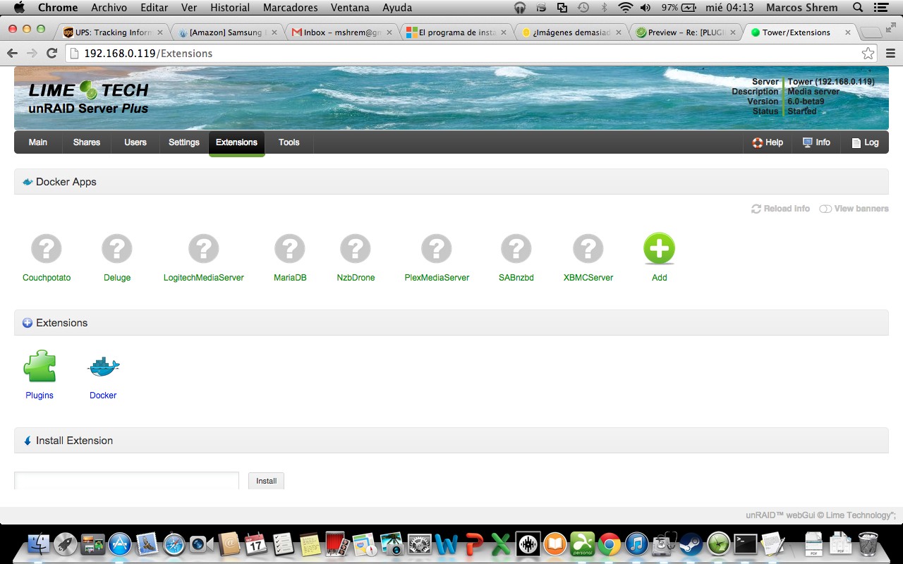

September 17, 201412 yr Hi guys i need some help here So i updated to V8 and everything was fine ... then the whole problem of data corruption so i as per recommendation i upgraded to V9 but now the plugin isn't working properly i cant seem to find the templates i only see my templates also all of the icons are gone and i cant access the apps via the apps menu you can check the attachment to see what i mean . Any help would be appreciated Thanks Shremi

September 17, 201412 yr Author Hi guys i need some help here So i updated to V8 and everything was fine ... then the whole problem of data corruption so i as per recommendation i upgraded to V9 but now the plugin isn't working properly i cant seem to find the templates i only see my templates also all of the icons are gone and i cant access the apps via the apps menu you can check the attachment to see what i mean . Any help would be appreciated Thanks Shremi Templates are not being distributed with this plugin anymore. Please take a look at the header of this topic. There's instructions to add a "Template Repo".
September 17, 201412 yr Hi guys i need some help here So i updated to V8 and everything was fine ... then the whole problem of data corruption so i as per recommendation i upgraded to V9 but now the plugin isn't working properly i cant seem to find the templates i only see my templates also all of the icons are gone and i cant access the apps via the apps menu you can check the attachment to see what i mean . Any help would be appreciated Thanks Shremi Templates are not being distributed with this plugin anymore. Please take a look at the header of this topic. There's instructions to add a "Template Repo". I am having the exact same issues after upgrading from 8 to 9. I was able to get the templates to reappear by readding the repo, but I'm still missing the icons and banners on the extensions page. I am also missing the settings on my installed docker conatainers. I tried installing https://raw.githubusercontent.com/limetech/dockerMan/master/dockerMan.plg on the add extension box, but I'm still not seeing settings or my templates. Do I need to delete the current plugin first or reboot to see my templates? Also does the upgrade form 8 to 9 require reinstalling all containers?

September 17, 201412 yr Author Hi guys i need some help here So i updated to V8 and everything was fine ... then the whole problem of data corruption so i as per recommendation i upgraded to V9 but now the plugin isn't working properly i cant seem to find the templates i only see my templates also all of the icons are gone and i cant access the apps via the apps menu you can check the attachment to see what i mean . Any help would be appreciated Thanks Shremi Templates are not being distributed with this plugin anymore. Please take a look at the header of this topic. There's instructions to add a "Template Repo". I am having the exact same issues after upgrading from 8 to 9. I was able to get the templates to reappear by readding the repo, but I'm still missing the icons and banners on the extensions page. I am also missing the settings on my installed docker conatainers. I tried installing https://raw.githubusercontent.com/limetech/dockerMan/master/dockerMan.plg on the add extension box, but I'm still not seeing settings or my templates. Do I need to delete the current plugin first or reboot to see my templates? Also does the upgrade form 8 to 9 require reinstalling all containers? See below: Also, maybe its just me, but I also have lost the ability to add docker containers via templates. The drop down menu just states "Select a Template". If I revert back to beta 8, all the templates are there, but they disappeared from my beta9 But, all of the containers which I was running before are still running. Sorry for that. We changed the user templates back to the flash drive: BETA 8 BETA 9 /var/lib/docker/unraid-templates /boot/config/plugins/dockerMan/templates-user cp -rf /var/lib/docker/unraid-templates/* /boot/config/plugins/dockerMan/templates-user/ While LT don't create their own containers, you can use several of community ones using the templates below. [glow=red,2,300]UPDATE:[/glow] To help the transition, I've created a template repository here: https://github.com/gfjardim/docker-containers/tree/templates After update the plugin, a new field will appear on the Docker extension page. Add this address there and click Save.
September 17, 201412 yr Hi guys i need some help here So i updated to V8 and everything was fine ... then the whole problem of data corruption so i as per recommendation i upgraded to V9 but now the plugin isn't working properly i cant seem to find the templates i only see my templates also all of the icons are gone and i cant access the apps via the apps menu you can check the attachment to see what i mean . Any help would be appreciated Thanks Shremi Templates are not being distributed with this plugin anymore. Please take a look at the header of this topic. There's instructions to add a "Template Repo". I am having the exact same issues after upgrading from 8 to 9. I was able to get the templates to reappear by readding the repo, but I'm still missing the icons and banners on the extensions page. I am also missing the settings on my installed docker conatainers. I tried installing https://raw.githubusercontent.com/limetech/dockerMan/master/dockerMan.plg on the add extension box, but I'm still not seeing settings or my templates. Do I need to delete the current plugin first or reboot to see my templates? Also does the upgrade form 8 to 9 require reinstalling all containers? See below: Also, maybe its just me, but I also have lost the ability to add docker containers via templates. The drop down menu just states "Select a Template". If I revert back to beta 8, all the templates are there, but they disappeared from my beta9 But, all of the containers which I was running before are still running. Sorry for that. We changed the user templates back to the flash drive: BETA 8 BETA 9 /var/lib/docker/unraid-templates /boot/config/plugins/dockerMan/templates-user cp -rf /var/lib/docker/unraid-templates/* /boot/config/plugins/dockerMan/templates-user/ While LT don't create their own containers, you can use several of community ones using the templates below. [glow=red,2,300]UPDATE:[/glow] To help the transition, I've created a template repository here: https://github.com/gfjardim/docker-containers/tree/templates After update the plugin, a new field will appear on the Docker extension page. Add this address there and click Save. OK, I've done all that and now everything seems to be working except my sickbeard contianer, It would start but I couldn't get the web gui so I removed it and tried to reninstall. I can't add the new container using my template or the one in the repo, I click add and the button turns grey but nothing happens, any ideas?
