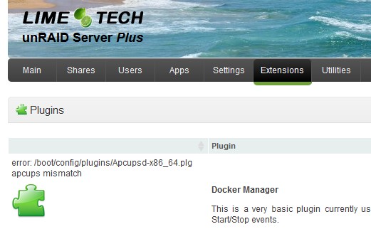

Works on beta 7. In the plugins page it shows up at the top with an error: /boot/config/Apcupsd-x86.plg apcups mismatch.
I tested it on beta8 and not on beta7.  I don't know what that error means.  It may be an error in the plugin manager.

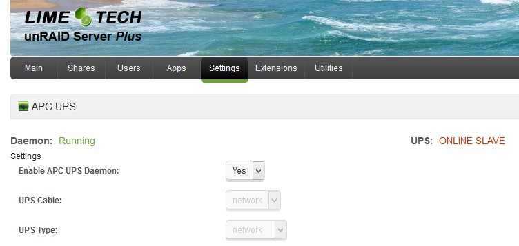

On a different version of the plg I have the settings page for APC UPS also shows the Load Percentage and Nominal Power.
Can these be added to your version please.
Kevin.
dlandon
Kevin.
Just added changes for this from dmacias.
Thank you. Works fine.

Also on the plug in page Extensions -> Plugin I am getting the following error and not seeing an icon or information about the plug-in even thought it's properly installed and working.
error: /boot/config/plugins/Apcupsd-x86_64.plg apcups mismatch
error: /boot/config/plugins/powerdown-x86_64.plg powerdown mismatch
This matches the error soana reported, earlier.
Thanks.  I'll fix the typo.
The earlier report was for b7.  If you are on b7, update to a later version.
Or maybe downgrade to b6, wait on b9, and don't worry about this plugin for now.
