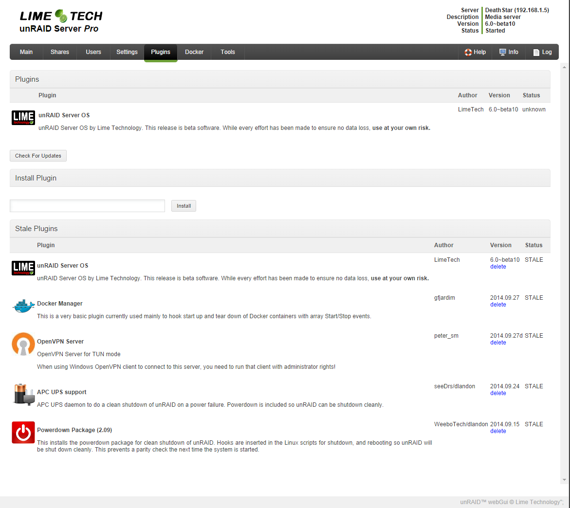

Not sure if this is a bug or not: but after using the webgui to update I see a stale version of unraid listed at the bottom as expected.  What is not expected is that it lists itself as beta10.  Looking at the flash drive I see a new folder v6.0-beta9.  Not causing a problem, but it doesn't seem right.
Also, I'm showing dockermanager needs an update but when I press update it just refreshes the screen and does nothing.
The stale version reported at the bottom is correct, but I can see how it's a little misleading.  You can click delete on it when done to remove.
As for the dockerman update, I'm also having that issue.  The update is linked to the limetech repo on github which Tom did update the dockerMan plugin just a few hours ago, but I'm not sure what's preventing the update from being pulled right now.  I'll sync up with him later today to see what's what on that...

Most of my plugins now show up under Stale Plugins. They still work though.
It's a problem with Plgman updating plugins.  Tom is aware of it.  It you reboot the plugins will return to the plugin webpage.
