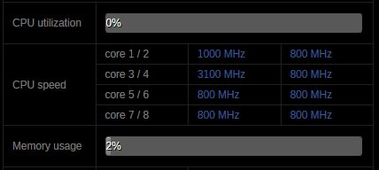

In KVM mode, there might be a cpu scaling driver issue with certain hardware combinations.  One of those drivers is called Intel-Pstate.  This is the chosen driver if your Intel cpu is Sandy Bridge (2011) or newer.  On my Haswell-class cpu (i7-4771) the Intel-Pstate driver is too sensitive and seems to keep the cpu frequency near the max frequency even when idle but occasionally it does scale the frequency down.
You can disable the Intel-Pstate driver by editing your /boot/syslinux/syslinux.cfg and adding a intel_pstate=disable parameter to the append line below:
label unRAID OS
  menu default
  kernel /bzimage
  append intel_pstate=disable initrd=/bzroot
Save the file, stop the array and reboot unRAID.  Doing this on my Haswell machine caused it to use the acpi-cpufreq scaling driver instead of the intel_pstate one.  It scales the frequency down like a rockstar now!  Usually keeps it around 800MHz - 1000MHz during idle now.
On the flip side, my other test machine, a year older Intel cpu (i5-3470) was able to scale down to 1600MHz (minimum) pretty consistently when using the intel_pstate driver... but when I disabled intel_pstate then there wasn't a scaling driver available.  For some reason the acpi-cpufreq driver wasn't compatible with this cpu.  Your mileage may very.
Give this a try and let me know if it helps you.  Either way, if it helped or not, let me know which cpu you tried with this command:
grep -m 1 'model name' < /proc/cpuinfo
I am running in plain unRAID mode and changing the driver does work for me; using an Intel Core i3-4130T processor.
It used to stay at max frequency all the time (I could see it drop to lower frequencies for very short periods), now it nicely scales down as it used to do.
Disabling intel_pstate works like a champ for me.
returns
Intel(R) Xeon(R) CPU E3-1240 v3 @ 3.40GHz
Cpu's are now mostly sitting at 800Mhz and ramping up when necessary

Hi eschultz,
Is working for me  ...
CPU on the server is.. ((Intel® Xeon® CPU E3-1270 v3 @ 3.50GHz))
The cpu was always around  (3500  3700MHz all the time)
now with this,
is all the way down to 800MHz and the load is 50-54 watts
Is all good!! 8) 8)
Mmm  let see what happens when the server is busy?
Thanks you, eschultz
