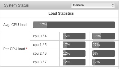

Not working in my case. With almost no load (see screenshot):
root@Tower:~# cat /proc/cpuinfo |egrep -i mhz
cpu MHz		: 3500.000
cpu MHz		: 3500.000
cpu MHz		: 3499.863
cpu MHz		: 3499.863
cpu MHz		: 3500.000
cpu MHz		: 3500.000
cpu MHz		: 3500.000
cpu MHz		: 3499.863
When I launched the command web dashboard was closed.

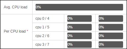

My i3-4160 is stepping down perfectly in unraid 6.2, both on the Dashboard and with the "cat /proc/cpuinfo |egrep -i mhz" command.
I clearly see all four available cores idling at around 0% on the Dashboard screen, even while it is open and cpuinfo reporting 800MHz speeds with the occasional core going up to around 1100MHz if something polls.

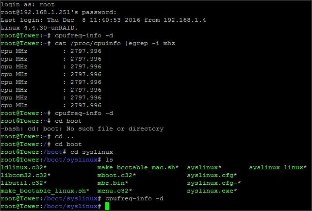

I researched this issue because the Plugin "Fix Common Problems" listed my CPU possibly will not throttle down frequency at idle. I made the change to the syslinux.cfg file, saved, verified the change and rebooted but my i7-860 Lynnfield is still running at full 2.8 GHz when at idle. I am running a newly built 17 drive Unraid 6.2.4. Reading the replies the solution will not come easy due to the many different CPUs. I will keep my fingers crossed and thank you!
cpu MHz        : 2797.996
cpu MHz        : 2797.996
cpu MHz        : 2797.996
cpu MHz        : 2797.996
cpu MHz        : 2797.996
cpu MHz        : 2797.996
cpu MHz        : 2797.996
cpu MHz        : 2797.996
Just as a background that might help, that test was suggested by RobJ, and is simply the output of the command
cpufreq-info -d
If there is no output from that command, then FCP flags it as a possibility that the CPU will never step down.
Thank for your reply Squid. The command "cpufreq-info -d" did not return an output.
