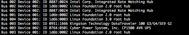

    I automated steps 1-9 of this guide.   The output shows USB bus #, PCI Address, and IOMMU group #   Bus 1 PCI 0000:00:1a.0 IOMMU 20     Intel Corp.     Linux Foundation 2.0 root hub Bus 2

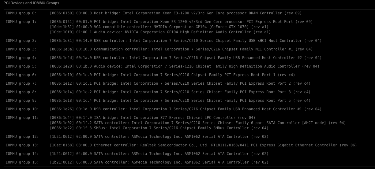

Here is my IOMMU groups
IOMMU group 0
    [8086:6f81] ff:0b.0 System peripheral: Intel Corporation Xeon E7 v4/Xeon E5 v4/Xeon E3 v4/Xeon D R3 QPI Link 0/1 (rev 01)
    [8086:6f36] ff:0b.1 Performance counters: Intel Corporation Xeon E7 v4/Xeon E5 v4/Xeon E3 v4/Xeon D R3 QPI Link 0/1 (rev 01)
    [8086:6f37] ff:0b.2 Performance counters: Intel Corporation Xeon E7 v4/Xeon E5 v4/Xeon E3 v4/Xeon D R3 QPI Link 0/1 (rev 01)
    [8086:6f76] ff:0b.3 System peripheral: Intel Corporation Xeon E7 v4/Xeon E5 v4/Xeon E3 v4/Xeon D R3 QPI Link Debug (rev 01)
IOMMU group 1
    [8086:6fe0] ff:0c.0 System peripheral: Intel Corporation Xeon E7 v4/Xeon E5 v4/Xeon E3 v4/Xeon D Caching Agent (rev 01)
    [8086:6fe1] ff:0c.1 System peripheral: Intel Corporation Xeon E7 v4/Xeon E5 v4/Xeon E3 v4/Xeon D Caching Agent (rev 01)
    [8086:6fe2] ff:0c.2 System peripheral: Intel Corporation Xeon E7 v4/Xeon E5 v4/Xeon E3 v4/Xeon D Caching Agent (rev 01)
    [8086:6fe3] ff:0c.3 System peripheral: Intel Corporation Xeon E7 v4/Xeon E5 v4/Xeon E3 v4/Xeon D Caching Agent (rev 01)
    [8086:6fe4] ff:0c.4 System peripheral: Intel Corporation Xeon E7 v4/Xeon E5 v4/Xeon E3 v4/Xeon D Caching Agent (rev 01)
    [8086:6fe5] ff:0c.5 System peripheral: Intel Corporation Xeon E7 v4/Xeon E5 v4/Xeon E3 v4/Xeon D Caching Agent (rev 01)
IOMMU group 2
    [8086:6ff8] ff:0f.0 System peripheral: Intel Corporation Xeon E7 v4/Xeon E5 v4/Xeon E3 v4/Xeon D Caching Agent (rev 01)
    [8086:6ff9] ff:0f.1 System peripheral: Intel Corporation Xeon E7 v4/Xeon E5 v4/Xeon E3 v4/Xeon D Caching Agent (rev 01)
    [8086:6ffc] ff:0f.4 System peripheral: Intel Corporation Xeon E7 v4/Xeon E5 v4/Xeon E3 v4/Xeon D Caching Agent (rev 01)
    [8086:6ffd] ff:0f.5 System peripheral: Intel Corporation Xeon E7 v4/Xeon E5 v4/Xeon E3 v4/Xeon D Caching Agent (rev 01)
    [8086:6ffe] ff:0f.6 System peripheral: Intel Corporation Xeon E7 v4/Xeon E5 v4/Xeon E3 v4/Xeon D Caching Agent (rev 01)
IOMMU group 3
    [8086:6f1d] ff:10.0 System peripheral: Intel Corporation Xeon E7 v4/Xeon E5 v4/Xeon E3 v4/Xeon D R2PCIe Agent (rev 01)
    [8086:6f34] ff:10.1 Performance counters: Intel Corporation Xeon E7 v4/Xeon E5 v4/Xeon E3 v4/Xeon D R2PCIe Agent (rev 01)
    [8086:6f1e] ff:10.5 System peripheral: Intel Corporation Xeon E7 v4/Xeon E5 v4/Xeon E3 v4/Xeon D Ubox (rev 01)
    [8086:6f7d] ff:10.6 Performance counters: Intel Corporation Xeon E7 v4/Xeon E5 v4/Xeon E3 v4/Xeon D Ubox (rev 01)
    [8086:6f1f] ff:10.7 System peripheral: Intel Corporation Xeon E7 v4/Xeon E5 v4/Xeon E3 v4/Xeon D Ubox (rev 01)
IOMMU group 4
    [8086:6fa0] ff:12.0 System peripheral: Intel Corporation Xeon E7 v4/Xeon E5 v4/Xeon E3 v4/Xeon D Home Agent 0 (rev 01)
    [8086:6f30] ff:12.1 Performance counters: Intel Corporation Xeon E7 v4/Xeon E5 v4/Xeon E3 v4/Xeon D Home Agent 0 (rev 01)
IOMMU group 5
    [8086:6fa8] ff:13.0 System peripheral: Intel Corporation Xeon E7 v4/Xeon E5 v4/Xeon E3 v4/Xeon D Memory Controller 0 - Target Address/Thermal/RAS (rev 01)
    [8086:6f71] ff:13.1 System peripheral: Intel Corporation Xeon E7 v4/Xeon E5 v4/Xeon E3 v4/Xeon D Memory Controller 0 - Target Address/Thermal/RAS (rev 01)
    [8086:6faa] ff:13.2 System peripheral: Intel Corporation Xeon E7 v4/Xeon E5 v4/Xeon E3 v4/Xeon D Memory Controller 0 - Channel Target Address Decoder (rev 01)
    [8086:6fab] ff:13.3 System peripheral: Intel Corporation Xeon E7 v4/Xeon E5 v4/Xeon E3 v4/Xeon D Memory Controller 0 - Channel Target Address Decoder (rev 01)
    [8086:6fac] ff:13.4 System peripheral: Intel Corporation Xeon E7 v4/Xeon E5 v4/Xeon E3 v4/Xeon D Memory Controller 0 - Channel Target Address Decoder (rev 01)
    [8086:6fad] ff:13.5 System peripheral: Intel Corporation Xeon E7 v4/Xeon E5 v4/Xeon E3 v4/Xeon D Memory Controller 0 - Channel Target Address Decoder (rev 01)
    [8086:6fae] ff:13.6 System peripheral: Intel Corporation Xeon E7 v4/Xeon E5 v4/Xeon E3 v4/Xeon D DDRIO Channel 0/1 Broadcast (rev 01)
    [8086:6faf] ff:13.7 System peripheral: Intel Corporation Xeon E7 v4/Xeon E5 v4/Xeon E3 v4/Xeon D DDRIO Global Broadcast (rev 01)
IOMMU group 6
    [8086:6fb0] ff:14.0 System peripheral: Intel Corporation Xeon E7 v4/Xeon E5 v4/Xeon E3 v4/Xeon D Memory Controller 0 - Channel 0 Thermal Control (rev 01)
    [8086:6fb1] ff:14.1 System peripheral: Intel Corporation Xeon E7 v4/Xeon E5 v4/Xeon E3 v4/Xeon D Memory Controller 0 - Channel 1 Thermal Control (rev 01)
    [8086:6fb2] ff:14.2 System peripheral: Intel Corporation Xeon E7 v4/Xeon E5 v4/Xeon E3 v4/Xeon D Memory Controller 0 - Channel 0 Error (rev 01)
    [8086:6fb3] ff:14.3 System peripheral: Intel Corporation Xeon E7 v4/Xeon E5 v4/Xeon E3 v4/Xeon D Memory Controller 0 - Channel 1 Error (rev 01)
    [8086:6fbc] ff:14.4 System peripheral: Intel Corporation Xeon E7 v4/Xeon E5 v4/Xeon E3 v4/Xeon D DDRIO Channel 0/1 Interface (rev 01)
    [8086:6fbd] ff:14.5 System peripheral: Intel Corporation Xeon E7 v4/Xeon E5 v4/Xeon E3 v4/Xeon D DDRIO Channel 0/1 Interface (rev 01)
    [8086:6fbe] ff:14.6 System peripheral: Intel Corporation Xeon E7 v4/Xeon E5 v4/Xeon E3 v4/Xeon D DDRIO Channel 0/1 Interface (rev 01)

I've been passing one of my USB 2.0 busses through for a long time (1a.0 called USB1). Now I want to pass through my USB 3.0 bus. However, here's what I find from the various commands and SysDevs. The problem is that both USB4 (USB 3.0 port I want to pass through) and USB3 (one of the other USB 2.0 ports) both show up as 14.0 with a readlink command and my unRAID USB is on USB3 (the Kingston DataTraveller).
So I don't know whether or not its safe to pass the IOMMU group that 0.14 is in through (that's group 2 from what I can tell....but maybe not!).
Thoughts?

No it's not safe to pass through 00:14.0 as your unraid usb is on that controller.
You could play with the EHCI and XHCI hand-off and the other USB options in the bios, to see if you manage to separate them.
