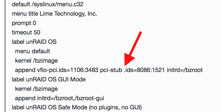

Maybe worth a shot, you could try using pci-stub.ids=  instead of  vfio-pci.ids=    in the syslinux.config.

Picked up a PCI USB controller. I have forwarded it to the VM but it won't start. I am getting the following message:
"internal error: process exited while connecting to monitor: 2017-04-15T04:22:29.755497Z qemu-system-x86_64: -device vfio-pci,host=01:00.0,id=hostdev1,bus=pci.0,addr=0x6: vfio: error, group 1 is not viable, please ensure all devices within the iommu_group are bound to their vfio bus driver.
2017-04-15T04:22:29.755526Z qemu-system-x86_64: -device vfio-pci,host=01:00.0,id=hostdev1,bus=pci.0,addr=0x6: vfio: failed to get group 1
2017-04-15T04:22:29.755536Z qemu-system-x86_64: -device vfio-pci,host=01:00.0,id=hostdev1,bus=pci.0,addr=0x6: Device initialization failed"
My Syslinux config is:

Seems like you may have other devices in the iommu group which the usb controller is in. please post your iommu groups and system devices
maybe that is because of the extra space?
58f35e8207195_ScreenShot2017-04-16at8_05_49AM.png.a239a784ec35c0c398fbd21813f1ff16.png
I don't know.
"pci-stub .ids=8086:1521" is my 4 port gigabit ethernet NIC. It seems to work with that space so I have no idea as to whether it should have it or not.
Looking over other usage of pci-stub on these forums it always seems to have a space between the b and the period mark.
I have no idea how you add multiple pci devices in the syslinux config so I preumed you just put multiple entries.
Edited by darrenyorston
1 hour ago, darrenyorston said:
I don't know.
It's not supposed to be a space in it.
8 hours ago, darrenyorston said:
I don't know.
Also, you are using 2 different ways of "stubbing the devices"
The new way is using vfio-pci and the older way using pci-stub
Just use  vfio-pci
For more than one device separate with a comma
ie
append  vfio-pci.ids=1b73:1100,8086:15a1 initrd=/bzroot
