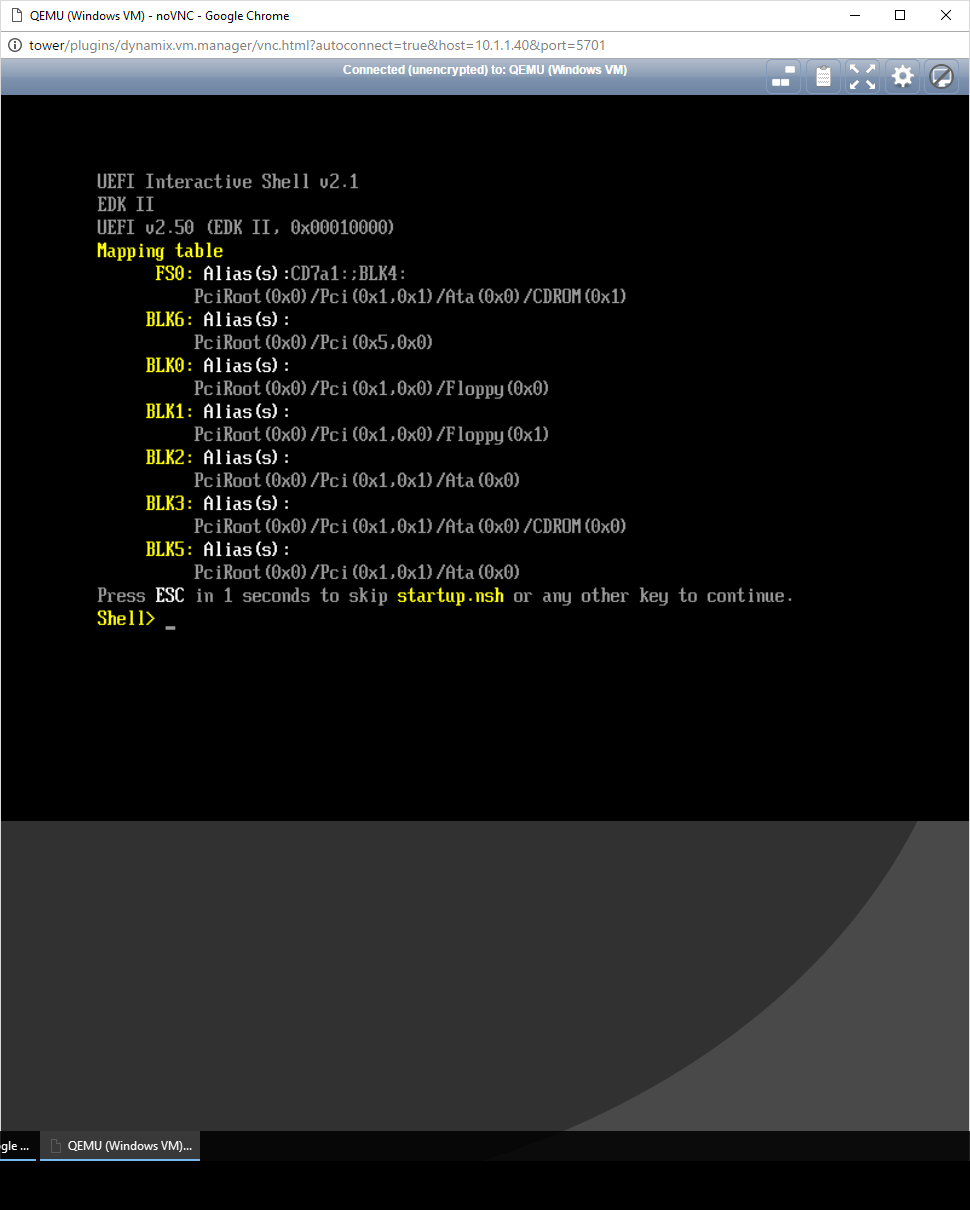

IOMMU group 3
	[8086:a12f] 00:14.0 USB controller: Intel Corporation Sunrise Point-H USB 3.0 xHCI Controller (rev 31)
well,
looks like the 'USB 2.0 onboard' and the 'USB 3.0 Header',
sharing the same bus (BUS 001).
I only want to passthru all the devices from Bus 001,
how do I do that?
I had similar issue..  and when in XHCI you cannot seem to separate the Intel controllers to pass them through. I had to make a BIOS setting change (relating to EHCI/OHCI/XHCI - varies on mobo vendor) which effectively makes them USB 2.0 only but splits the controllers. Then you can pass through one.
Q: Without boring for reason as to WHY I need to but if I want add another USB 3.0 controller card does it have to be a different chipset (NEC/Etron/VIA etc) OR can I put an identical card in and pass that through as well?
Does anyone have any insight if I could pass though group 16 to a VM for the USB controller without too much hassle?
This is with ACS override on, I'll try rebooting later to see what the groups are like without it on again but they are not great for anything other than GPU's.
