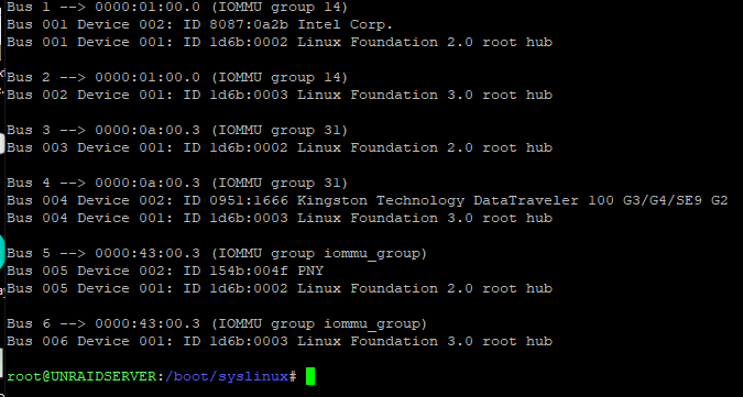

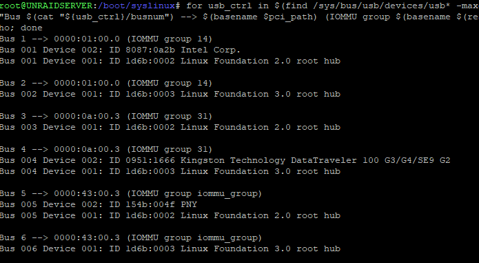

Hi Everyone,
Does anyone know how to pass the following through without turning on PCI-E ACSD Override?
root@Tower:~# readlink /sys/bus/usb/devices/usb6
../../../devices/pci0000:00/0000:00:01.0/0000:01:00.0/usb6
When I turn on the override the card seems to pass through initially.  But then overtime it just disappears.  I will not show up again until I I reboot UNRAID but it will not passthrough again.
Here is what I put in my XML:
      <driver name='vfio'/>
      <source>
        <address domain='0x0000' bus='0x01' slot='0x00' function='0x0'/>
      </source>
    </hostdev>
<memballoon model='virtio'>
WARNING: DO NOT DO THIS UNLESS YOU ARE 100% SURE THAT THE UNRAID USB IS NOT ON THIS CONTROLLER! IF YOU DO THIS WITH THE CONTROLLER THAT UNRAID IS USING YOUR PC/SERVER WILL NOT BOOT!
If one or more (four on my server) usb ports dont work after passing through a usb controller you have to do this:
