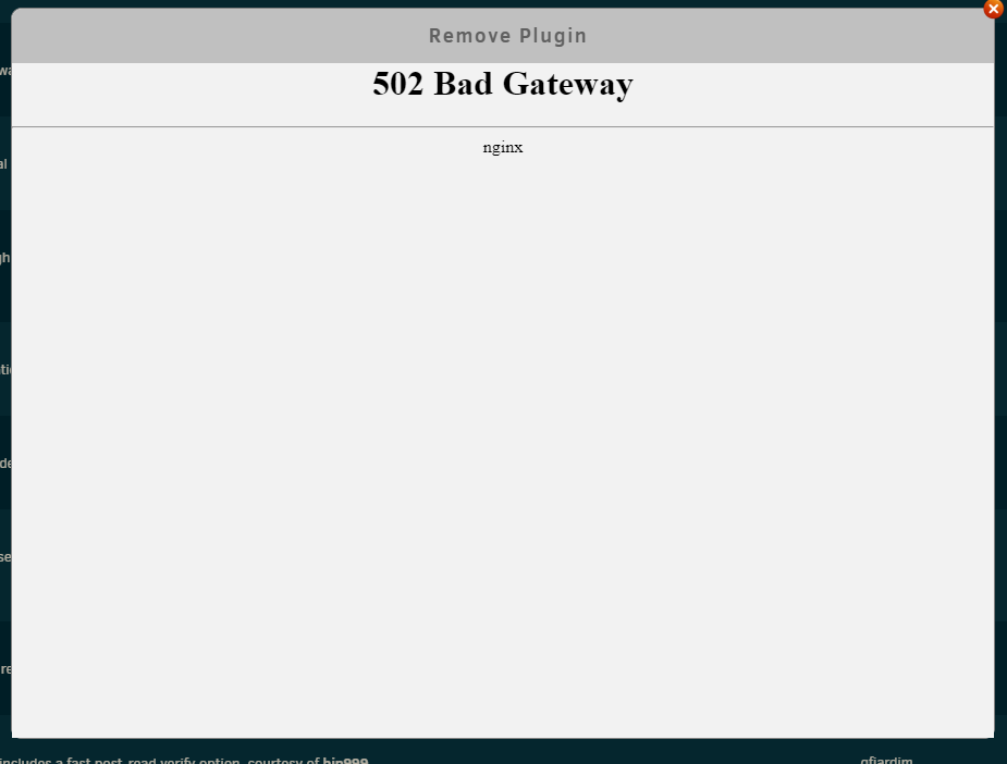

Can't remove the plugin:
Could be something going on with your flash. But the only other way to completely remove it, would be to delete the directory on the flash and reboot. Could also just be some aware blocker or anti-virus.
No adware or antivirus. All was working perfectly a couple of days ago.
How can I tell if there's an issue with the flash? All other read/write behaviour is normal. I can install/uninstall dockers and apps fine. It's a brand new drive.
In any case, it seems this is the issue rather than the filename of fping package I'm trying to install.
Edited by cinereus
I get this if I try to uninstall other plugins as a test:
However rebooting seems to have fixed it so thanks for your help.
