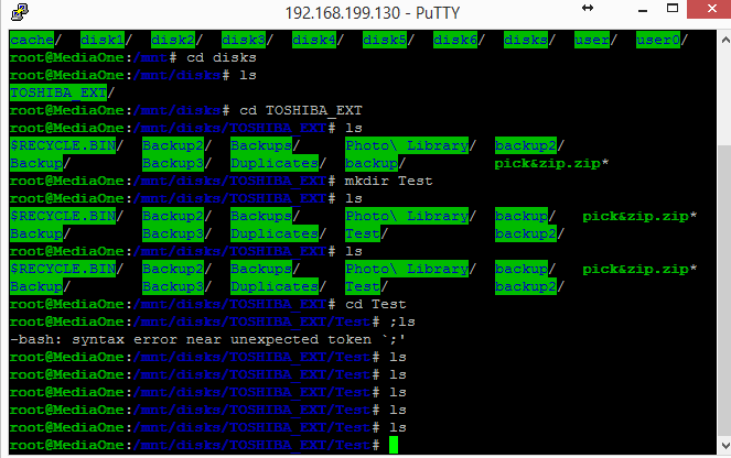

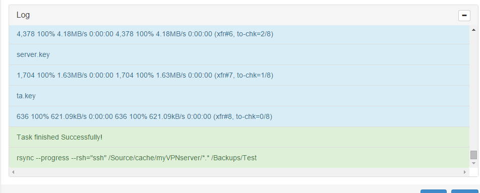

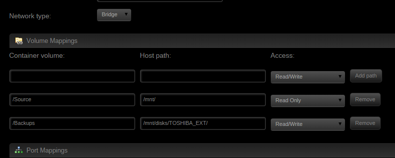

Just stumbled across this! but i cannot seem to get the transfer to physically happen
I have mapped Source which appears to be correct and is selecting the files for transfer. It appears to be copying to somewhere, just not where i thought i had directed it.
I have attached the docker settings, websync settings, success report and the putty empty directory.
Can you have a look and see why i have gone wrong?
Also I noticed when editing the container that the Tasks section is blank, does it not store previously configured tasks?
I have just renamed the external USB disk (mounted with Unassigned Devices plugin) from TOSHIBA_EXT to TOSHIBA just incase there was any issue with the underscore.
in the /disks/ directory there is now TOSHIBA/ which links to the USB disk, and there is also TOSHIBA_EXT which has the rsynced files in but this is not the external disk??
so i have no idea where this is, it has created a folder duplicating the drive mounted name in the /mnt/disks/ section - will try and track down if this is cache or array.
Reboot sorted this issue out.
