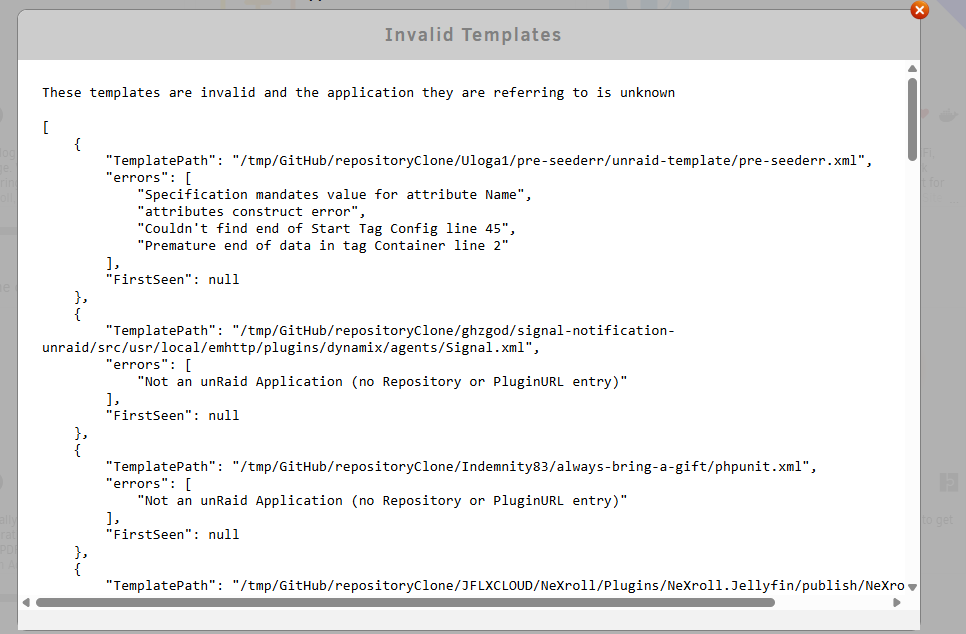

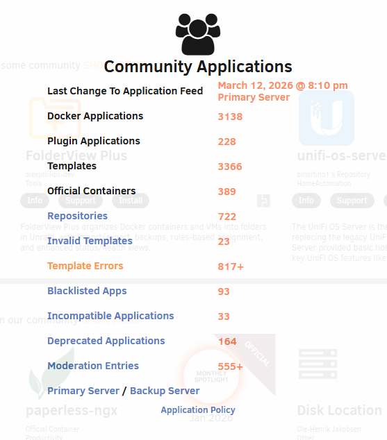

Anyone can always look at the statistics pop up in CA and click the link for template errors and see what templates have what wrong with them.  CA has numerous tests and fixes for various common mistakes that authors make on their templates, and the stats display will show everything that is happening under the hood.
