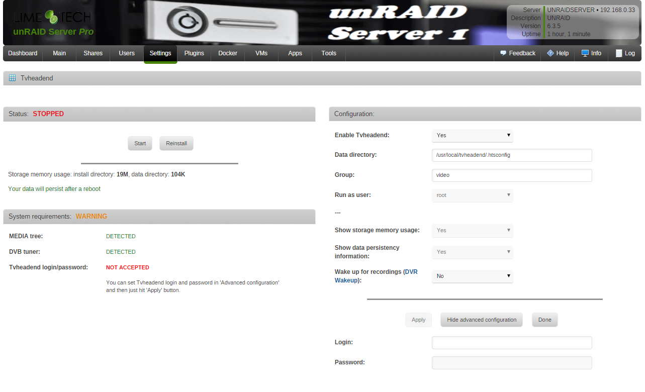

ok, I thought I would try this plugin over the docker as you say it is the best ;-)  however, I cannot connect to it?
I have tried
http://192.168.0.33:9981
http://unraidserver:9981
unraidserver:9981
nothing? the plugin is installed but I cannot see the gui?
You can see the status of tvheadend if you go to your unraid settings > tvheadend. Is it running? Is everything detected ok on the left side (media tree, dvb adapter, password)?
Well that was embarrassing!
Thank you :-)

 Can anyone tell me where I can find my superuser credentials to login please? I only have root and my normal users, none of which work?
Cheers
On the settings page there is a button "advanced configuration" where you can put in your superuser credentials. You can then add additional users through the tvheadend interface.
Many Thanks but I cannot type in there? I have tried stopping the plugin as well but it's greyed out?
I guess you can only change values there if you disable tvheadend at the top. Play with disable enable a bit. I know it can be a bit tricky ;)
While you're at it: Change the data directory to your cache drive. Something like: /mnt/cache/Apps/tvheadend
Edited by Mettbrot
mention data directory
That's great! thank you, I can now loging after disabling. entering details, re-enabling, I just have the issue where I don't think my dual tuner card is going to work as I can only get one tuner working :-(
