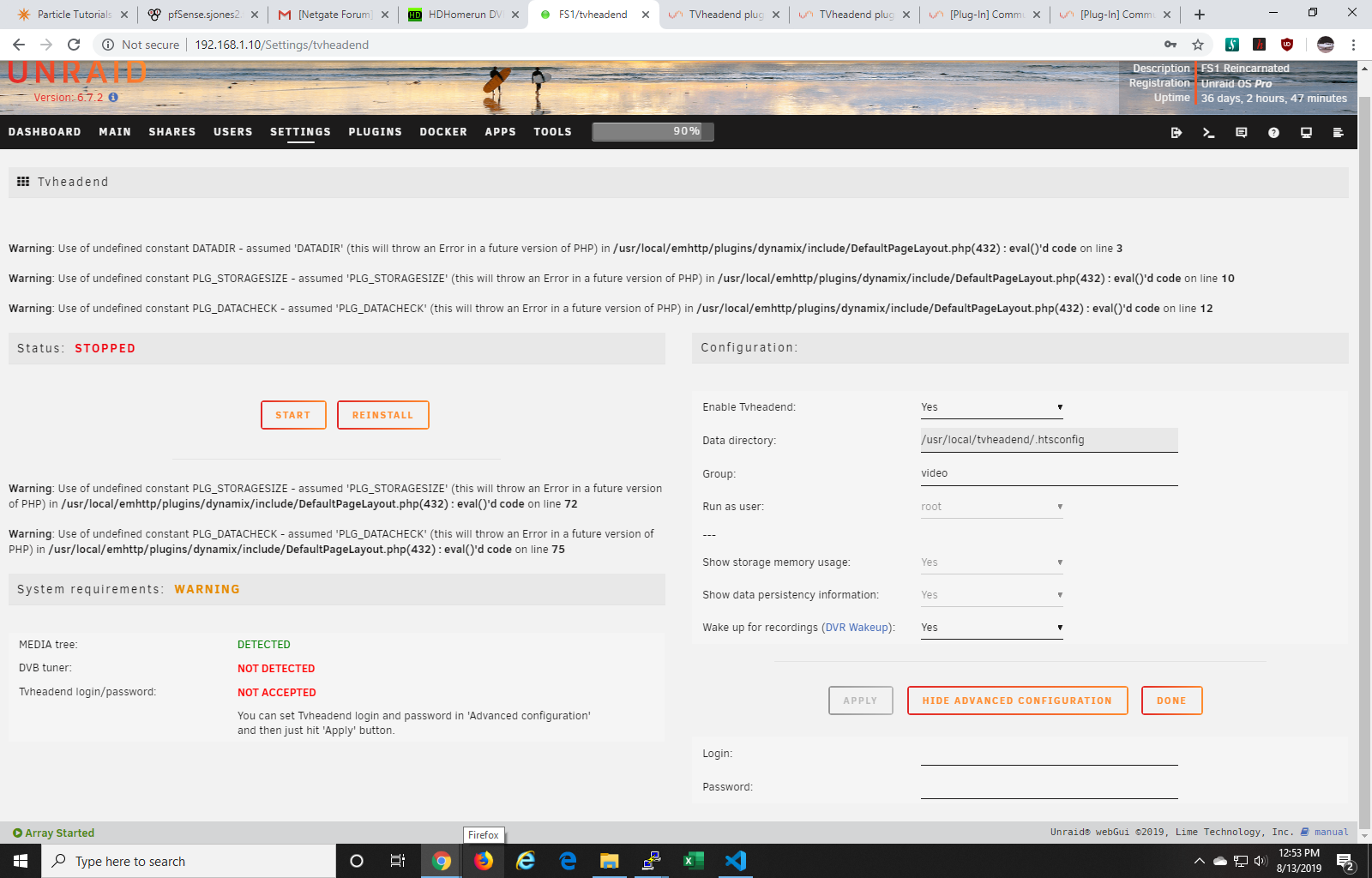

Having the same problem..  TVHeadEnd is stopped (Ive stopped and started many times, but can't figure this out!)  What do you mean disable "at the top"?
I also can't edit the data directory:
TIA..
Steve
TIA..
Steve
Hi Steve,
you may only change the settings if you flip the top most option of the plugin settings page to disable and apply.
Also, I pushed an update to remove the warnings on the settings page, thanks for the heads up!
