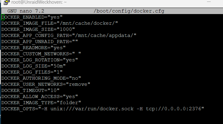

September 30, 20233 yr This topic is helpful. This is still the right approach today. ①Add it to config file /boot/config/docker.cfg DOCKER_OPTS="--storage-driver=btrfs -H unix:///var/run/docker.sock -H tcp://0.0.0.0:2375" ②restart dockerd service in terminal. /etc/rc.d/rc.docker restart

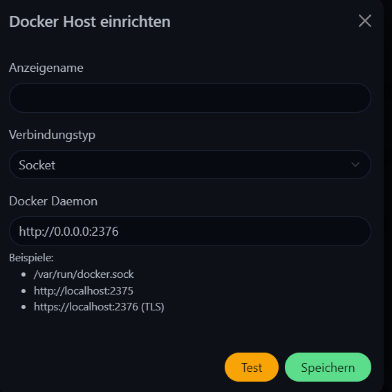

February 28, 20242 yr On 2/11/2024 at 5:10 AM, PlanetDyna said: Someone can have a quick look? I believe you are missing the storage-drive option: DOCKER_OPTS="--storage-driver=btrfs -H unix:///var/run/docker.sock -H tcp://0.0.0.0:2375"
February 29, 20242 yr Thank you. I will test it next days! Working! I missed change connection-type to "TCP/HTTP". Edited March 5, 20242 yr by PlanetDyna
