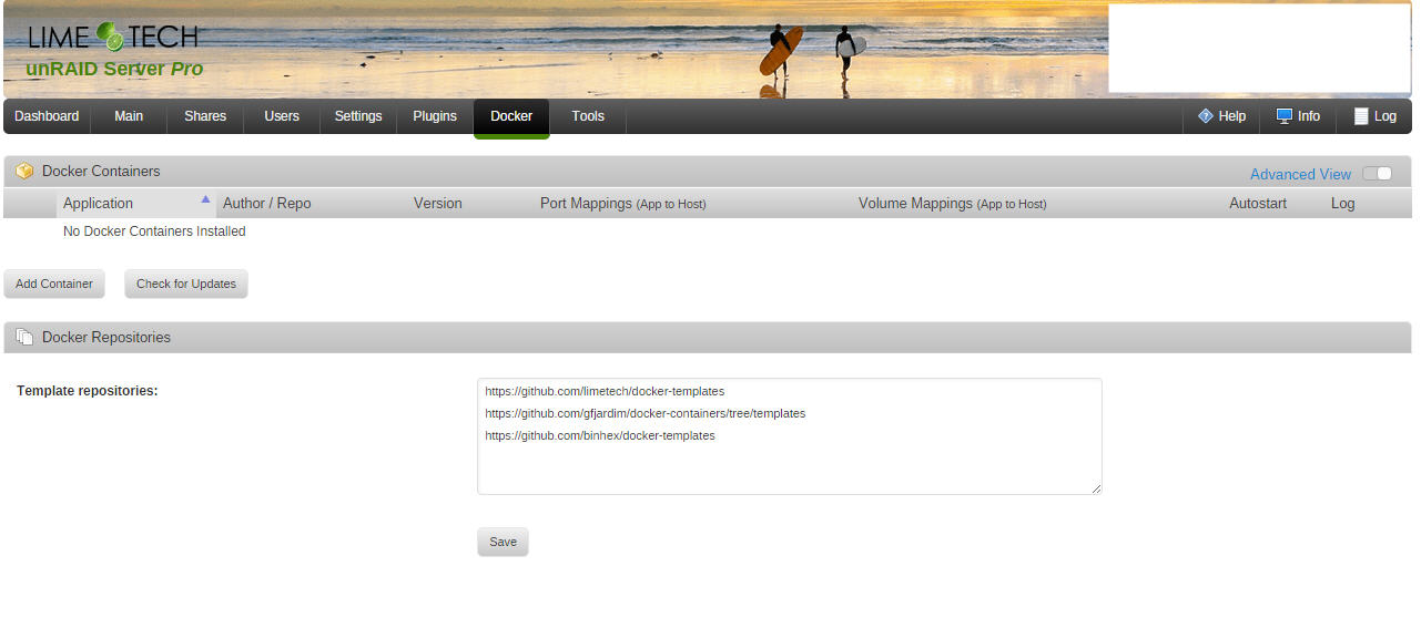

Just upgraded to 6.0.1, and the only issue I have so far is that I can't choose a template when adding  new docker container. See attached screenshots, what am I doing wrong?
