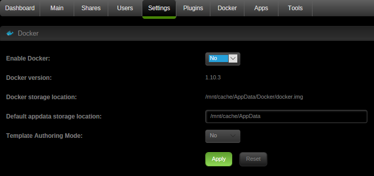

Settings ==> Docker ==> Advanced Toggle
The docker.img is wherever you have configured it to be...

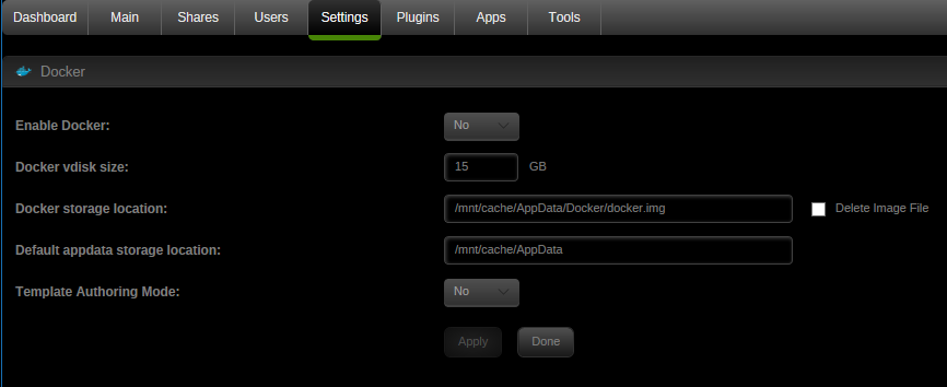

No need to do any of that. Use the Web UI and the Docker Settings page once Docker is stopped by changing "Docker Enabled" to No and clicking Apply, then checking the "Delete Image File" checkbox.
Thanks for showing the "Force Update" option, I couldn't get Plex to update but that did the trick  ;D
