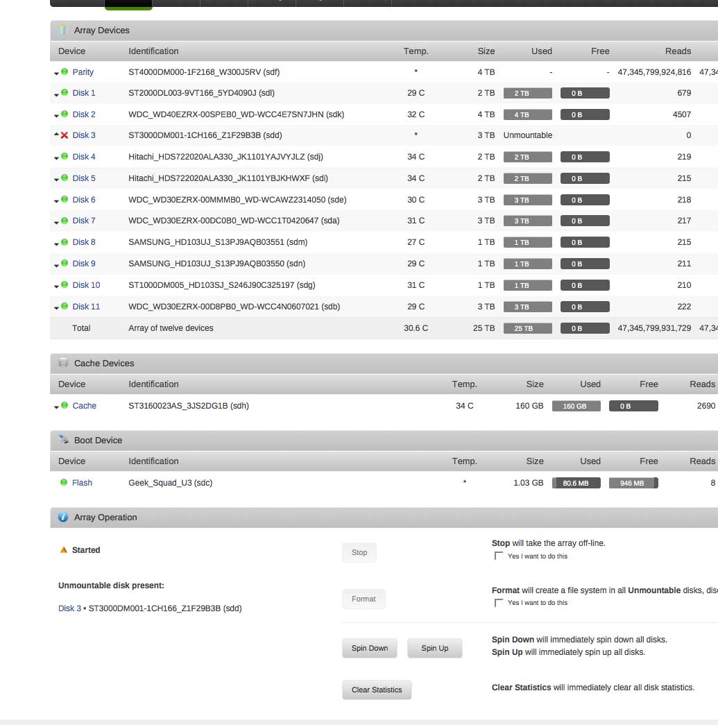

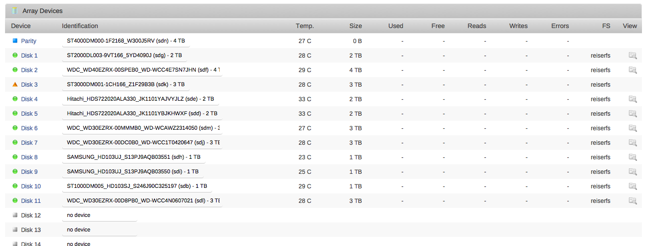

August 10, 201511 yr I am running unraid 6.0.1. a month ago one of my drives in the array died. i replaced it with a new 3tb drive, rebuilt the array and everything was great. parity checks were susccesfull etc. yesterday i got the warrantied replacement drive of the one that failed last month. Everything still showed good on the array. Shut it down, installed the new drive and fired it back up. The array did not detect the new drive (this is not the critical part). Additionally it then showed that the new 3tb drive i put in last month was now unmountable. I thought this was odd as the smart test ran fine. So i removed the 3tb drive from the array and added it back. Unraid started to restore the disk. Today i look to see how the restore process is going and it now shows the 3tb disk as unmountable and now the parity drive has been removed from the array. I shut the array down and rebooted its now showing the 3tb drive as still unmountable and it has now marked the parity drive as a new device. I am lost as what to do. I can not access the array data at all now. I do not understand why im having these wierd drive failures all of a sudden either.

August 10, 201511 yr Author heres a screenshot i saved right before the reboot which lead to the parity issue.
August 10, 201511 yr Community Expert Just noticed we're in the wrong subforum so I am going to move this topic. According to your description, parity and disk3 should both be good but I'm not sure how you could convince unRAID of that except for a new config with trust parity. Even if you do that though I think it will start a correcting parity check, which you could cancel but maybe not before it had made some "corrections". Still wondering about that other drive though. Are all these drives on the same controller?
August 10, 201511 yr Author here is exactly what transpired to get me to this point. 1. disk 3 failed (2tb drive) 2. replaced disk 3 with new drive (3tb, same slot, same cables) 3. unraid rebuilt disk 3 and ran a new parity check. everything OK. 4. a month later tried to add a new drive(2tb) to server. in a new slot with a new cable. 5. powered up server with new drive installed. 6. new drive is not detected. 7. parity still shows valid but now disk 3 has a red X and says drive unmountable. 8. ran a smart test on disk 3 everything seems fine with the drive. ran the disk restore procedure on disk 3 (still the same 3tb drive in the same location with same cables) thinking that the server would just rebuild disk 3. At this point still shows parity drive as active. Disk 3 is recognized as a new drive and ready to restore. 9. next day check to see the progress of the drive restore. 10. disk 3 again shows a red X and is unmountable. 11. shut down server, open case to check all the cables, everything looks good. 12. reboot the server. 13. now disk 3 shows with yellow triangle and says emulation and parity drive is now flagged as a new device. 14. started this thread. drives are on three different controllers. 5 drives on the mobo. 4 drives on a rocket raid card. 4 drives on a supermicro card. power supply = ult-v600dr
