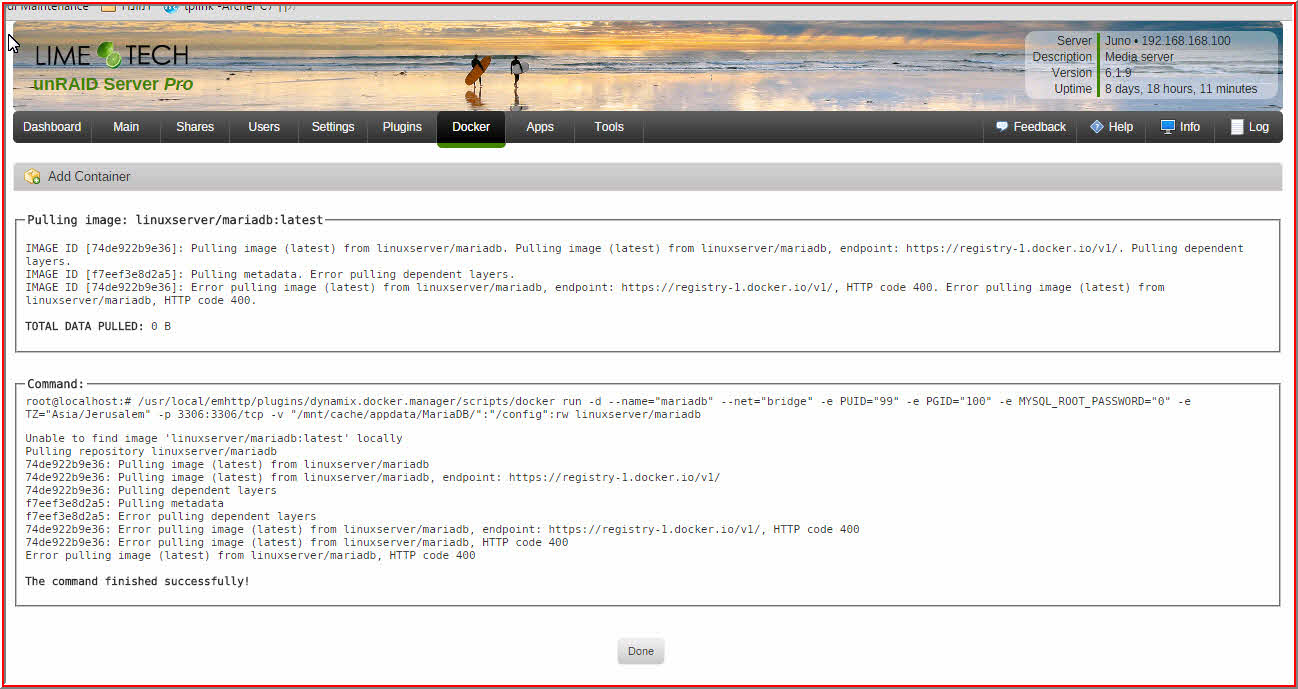

I have a problem pulling any of LinuxServer docker images.
Error pulling image (latest) from linuxserver/mariadb, endpoint: https://registry-1.docker.io/v1/, HTTP code 400. Error pulling image (latest) from linuxserver/mariadb, HTTP code 400.
TOTAL DATA PULLED: 0 B
Any way to see log/debug the pull request?
Alternatively how can I manually pull and install the docker images?
It's been like that for weeks and I'm quite desperate here.
Other dockers, even from the same docker hub server, are pulled successfully.
Thanks.

  • I'm just making a guess here, but it looks as they don't have a "latest" tag version, only develop/nightly versions.  Maybe they don't put up containers until they are fully finalized and released?
The best we can say is that it's an issue with dockerhub.  Why it is affecting our containers and nobody elses I can't say.  Usually with these issues it works after a little while, but if you've been having the problem for weeks that's unusual.  What are your DNS settings?
Not only your containers. Can't pull mace's Qbittorrent docker too.
DNS is set to my router's ip address, but I changed it to Google's DNS servers and no change - still can't pool your docker images.
I can pull other images from dockerhub so the DNS was a long shot anyway.
I tried dockerhub forums, and will try again, but is the another way to download a docker image and install it?
I don't know anything about unix, but the installation command is in the log so I guess it can be run manually (?).

i think this may be related to this email from dockerhub
Dear Docker Hub User,
TL;DR: If you use Pull-By-Digest, remember to upgrade to Docker Engine 1.10 by June 1st 2016.
On June 1st, 2016, we're upgrading Docker Hub to support the newest version of the Docker image manifest format. This will allow us to support images in multiple architectures and for multiple operating systems later.
This upgrade also changes how Pull-By-Digest works. This means that older Docker engine versions (1.7 to 1.9) won't be able to use Pull-By-Digest for images published by newer Docker versions (1.10 and later).
We see that you're using Pull-By-Digest with an older version of Docker Engine. If you don't upgrade, you'll only be able to use pull-by-digest on images published by older versions of Docker, and you’ll need to change your pull method to specify individual tags for some Docker images.
We want you to be able to use your preferred pull method on images published by any Docker version. To do this, you should upgrade to Docker Engine 1.10 by June 1st, 2016.
You can download Docker 1.10 here: https://www.docker.com/products/docker-toolbox
For more information on Image Manifest Version 2, Schema 2, please visit: https://github.com/docker/distribution/blob/master/docs/spec/manifest-v2-2.md
Thank you,
The Docker Hub Team
Long story short.  The version of docker on Unraid 6.1.9 is the problem then....
