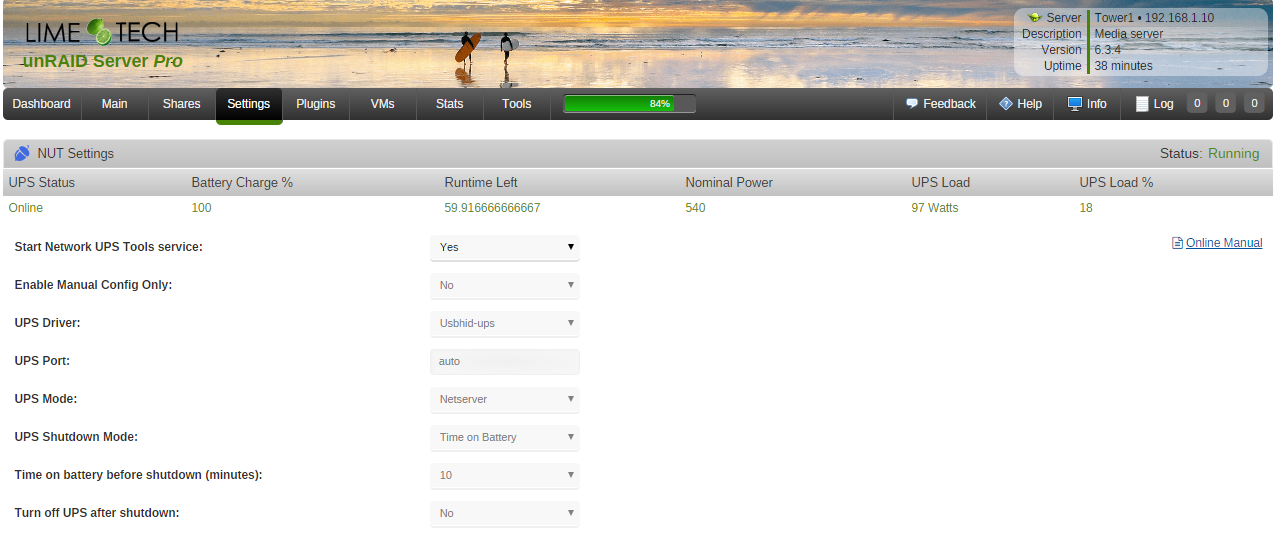

The "NUT Details" section looks far better now and I think it includes more usefull info too. I did some testing and everything works fine.
Only noticed I set the "Battery Level" to "20" but the system shutdown when it was showing "35%" (at the "UPS Status" top section) ... really a minor issue for me.
The shutdown process managed to do a clean shutdown of my running vw (w10) + Tower clean shutdown.
Thx again for updating this plugin for us:D
Rgds
Agree, looks very nice, just a request if possible, could the runtime display round to the closest minute, or display 1 or 2 decimals max?
