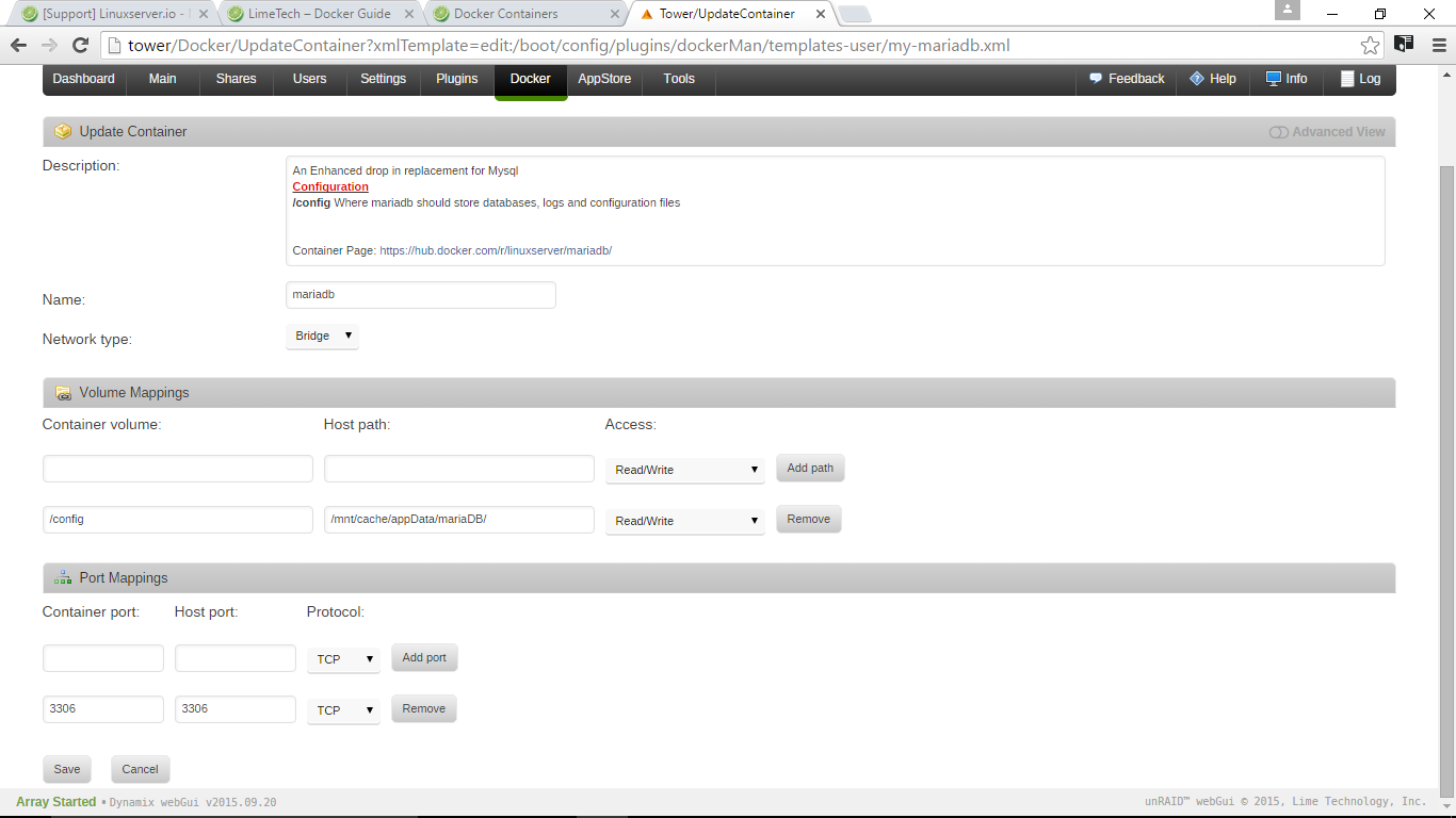

Can you post a screenshot or something of how you have your docker container setup...  (the bit where you fill in ports, folders etc)
Attached as requested, I've no Idea if I've done it correctly
is appData share set to cache only ?
yes, If thats set up wrong then please let me know the best way to set it up.
Thanks in advance.
