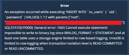

Hello.
Trying to setup ownCloud to work with this container.
When configuring owncloud for the first time, Im getting the attached error.
I've used needo's MaridaDB container before, now tried starting fresh with LinuxServer's version.
Any help would be appreciated.
i'm extremely averse to doing that, people use mariadb for more than just owncloud and there is no way of telling what implications those settings have for other apps that want to use it.
Take a look at https://github.com/owncloud/core/issues/16008#issuecomment-98844031.
Not a db expert myself, but it seems the better setting depends on the usage scenario.
BTW - is there a guide to replication between mariadb containers on different servers?
Sparklyballs and I have talked about this at length, the long and the short of it is this.  Owncloud have broken their database interface requiring a change to the MariaDB/MySQL setup, unfortunately the change that is required will affect every other database on the system.  Changing MariaDB to be compatible with a fault within Owncloud just seems fundamentally wrong and is not something we will be doing, as this may have deleterious effects on other programs which use MariaDB.
At the present time, you could use an older version of MariaDB like Sparklyballs version with webmin built in, which is what I'm currently doing, and if you want you could still run the up to date LS.io version on a different port for every other application.  Sparklyballs is also I know looking at another possible solution which we are still testing....

Incidentally you need to change the binlogging in MariaDB due to a fairly longstanding bug in Owncloud to do with binary logging in MariaDB/MySQL This is not something I've had to do myself as my setup is very different. (Not something I can offer as a solution though)
Sequence of install
1.  Install MariaDB
2.  Change Binlogging
3.  Install Owncloud and configure via the webui.
