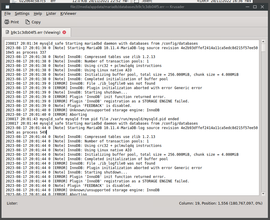

Noob here. I installed nextcloud using spaceinvaderone's tutorial and it has been running fine for like 2 years. I decided to add some drives and a second parity. That was accomplished without fault. Or so I thought. When I restarted everything all the apps were not there. I had to reinstall them by going to the "previous installed" tab.
Now I get this error from mariadb:
cp: not replacing '/config/custom.cnf'
[custom-init] No custom files found, skipping...
230820 08:40:26 mysqld_safe Logging to '/config/databases/b9c1c3db04f5.err'.
230820 08:40:26 mysqld_safe Starting mariadbd daemon with databases from /config/databases
I tried searching the interwebs for instructions but couldn't find anything. Not sure where to turn to next.
Thanks.
What is inside '/config/databases/b9c1c3db04f5.err
It should be under your appdata/mariadb folder.
Gesendet von meinem Pixel 6 Pro mit Tapatalk

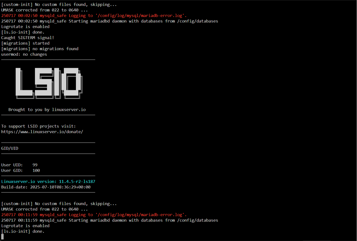

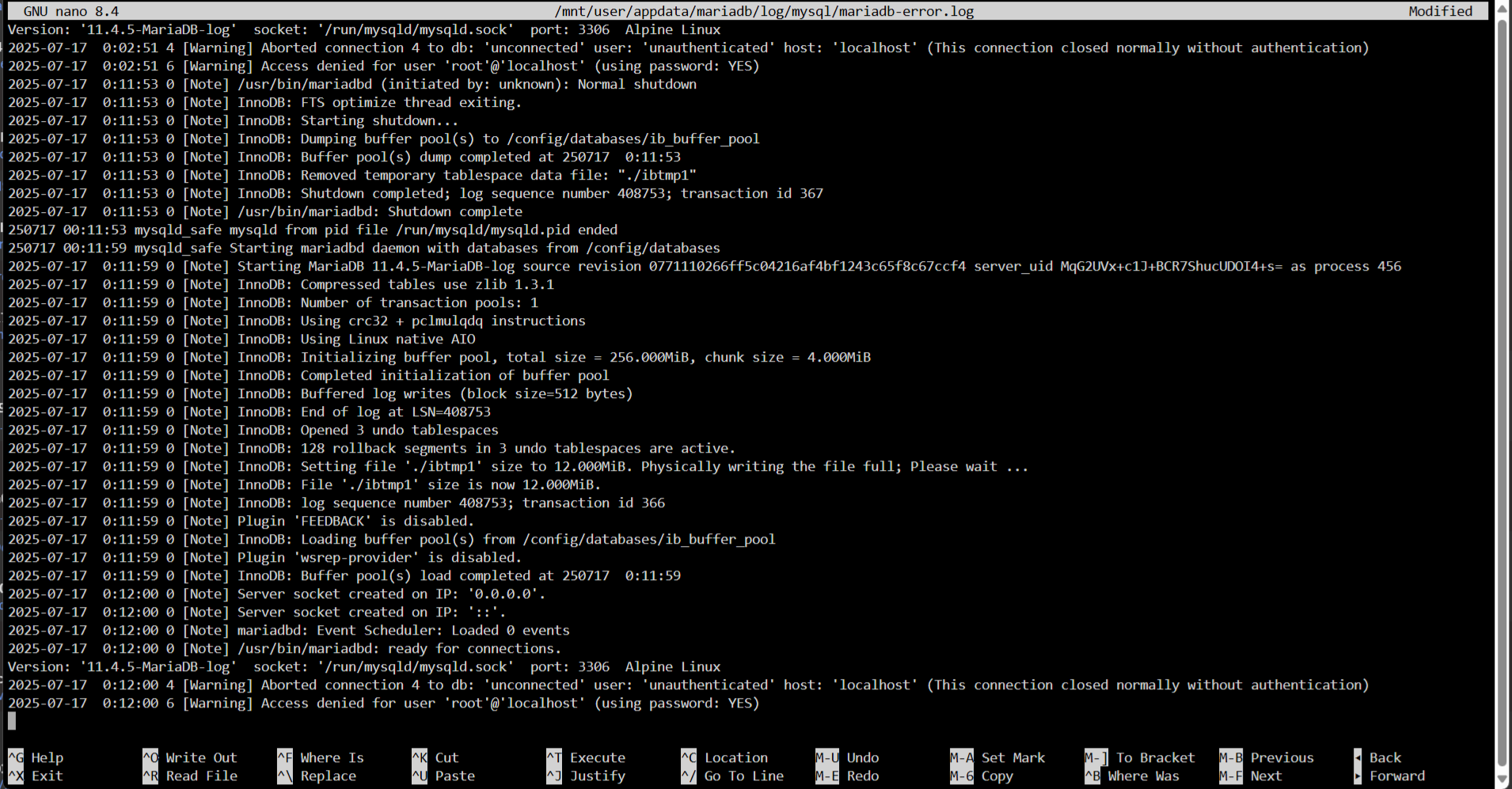

I'm having trouble with nextcloud and im hearing it has something to do with mariadb.  Everything was working fine prior to the failed upgrade of nextcloud. So i looked in my mariadb logs and its repeating this over and over again, 24/7.  Are there issues here or is this normal?
241030 15:00:59 mysqld_safe Logging to syslog.
241030 15:00:59 mysqld_safe Starting mysqld daemon with databases from /config/databases
241030 15:01:01 mysqld_safe Logging to syslog.
241030 15:01:01 mysqld_safe Starting mysqld daemon with databases from /config/databases
241030 15:01:02 mysqld_safe Logging to syslog.
241030 15:01:02 mysqld_safe Starting mysqld daemon with databases from /config/databases
241030 15:01:03 mysqld_safe Logging to syslog.
241030 15:01:03 mysqld_safe Starting mysqld daemon with databases from /config/databases
241030 15:01:05 mysqld_safe Logging to syslog.
241030 15:01:05 mysqld_safe Starting mysqld daemon with databases from /config/databases

After the upgrade i appear to be getting an error.
  • 4 months later...
Facing the same problem. Anybody who can help?
Logfile-information:
2025-07-15 0:53:48 4 [Warning] Aborted connection 4 to db: 'unconnected' user: 'unauthenticated' host: 'localhost' (This connection closed normally without authentication)
2025-07-15 0:53:48 6 [Warning] Access denied for user 'root'@'localhost' (using password: YES)
Many thanks!
Br
JEns
