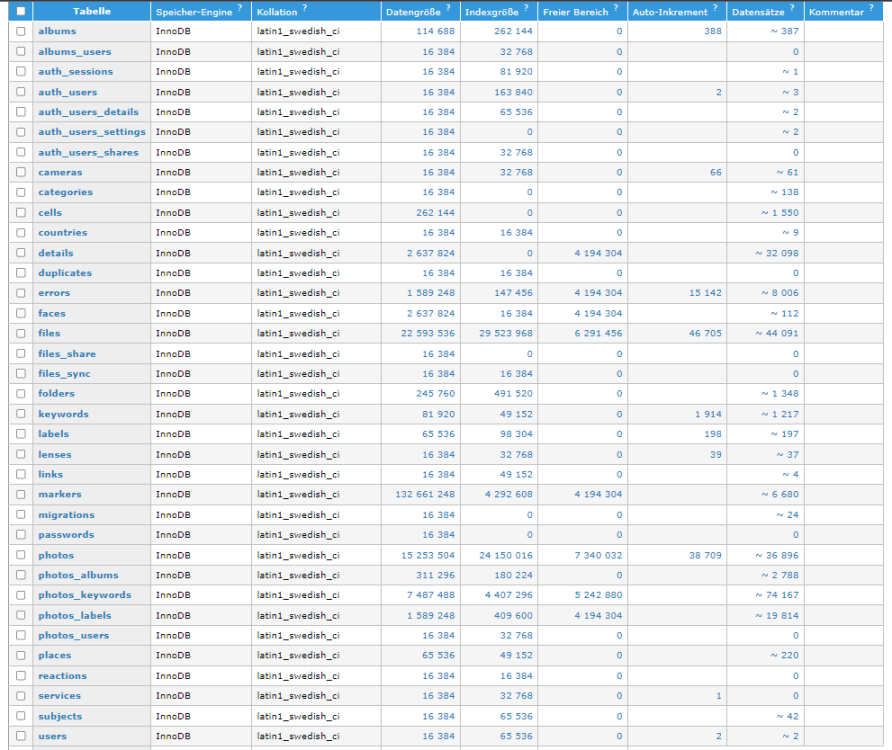

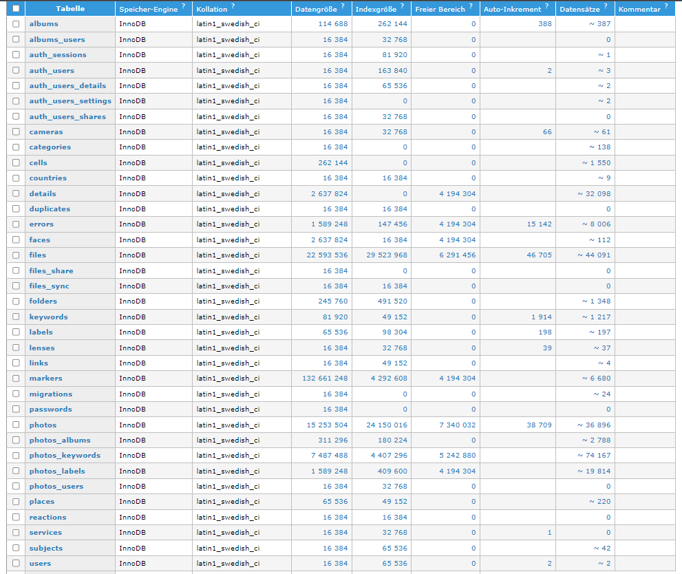

Hi!
I am using this MariaDB Docker with Photoprism. I just faced the following error messages:
2023-05-25 00:15:40 ERRO photo: Error 1366: Incorrect string value: '\xD9\x85\xD8\xB9\xD8\xA8...' for column `photoprism`.`cells`.`cell_name` at row 1 (find location)
2023-05-25 00:15:40 ERRO cell: record not found (find s2:143662db2c8c)
2023-05-25 00:15:40 ERRO cell: Error 1366: Incorrect string value: '\xD9\x85\xD8\xB9\xD8\xA8...' for column `photoprism`.`cells`.`cell_name` at row 1 (create s2:143662db2c8c)
2023-05-25 00:15:40 ERRO cell: Error 1366: Incorrect string value: '\xD9\x82\xD8\xB1\xD9\x8A...' for column `photoprism`.`places`.`place_city` at row 1 while creating place eg:Rh1HvnaYJdpT
This repeates very very often. I read that this has something to do with UTF-8 support. Can someone please help me how I can fix this?
PS: I took this screenshot of the Database.image.thumb.png.343726fbe85a68c4fff4b775d9175f68.png

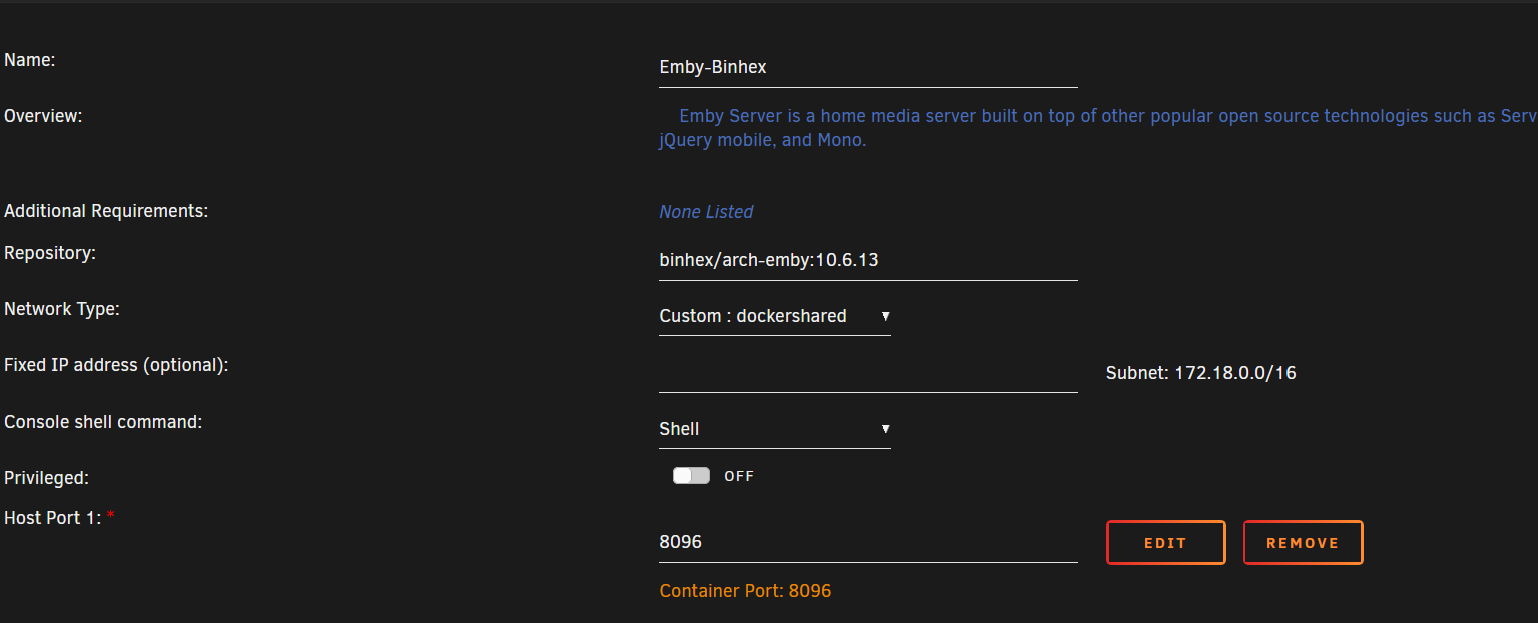

I know you didn't ask me but on the offchance Silentbob is in the US and asleep for 12 hours, here's the answer.
Forgive me for using Emby as my example. Different unraid box but the fix is exactly the same.

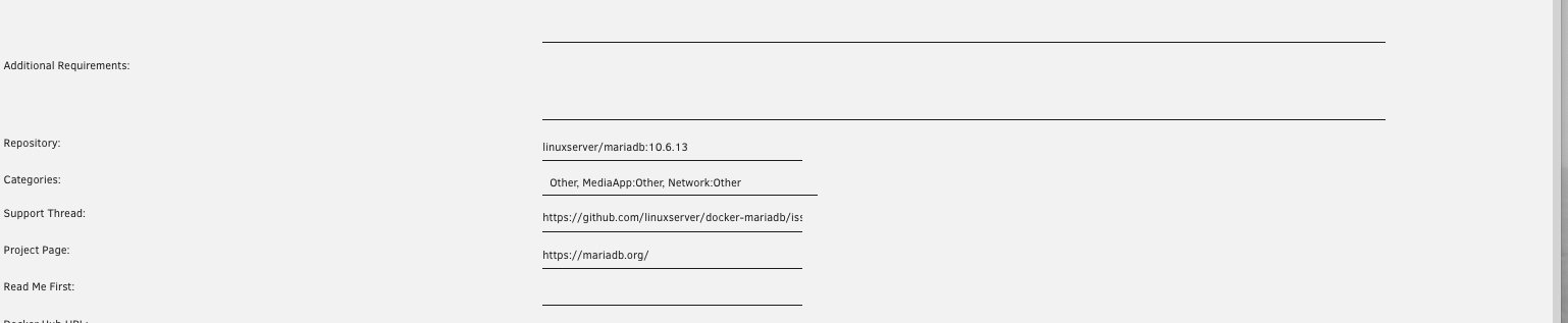

3 minutes ago, Martintheshred said:
Thanks for this Silentbob this is probably a stupid newbie question how do I do that?
Do I just open up the Unraid template and change it there?
It was a stupid Question Thanks Silentbob all I had to do was open up the template and type linuxserver/mariadb:10.6.13 into the repository section and it work. just need to remember that for nexttime

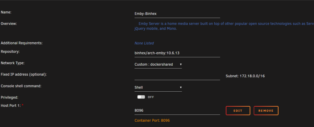

Cheers for this Elmuziko thats what I did on the off chance that well if its broken I cannot make it any worse (LOL) and change it to this below I was just reply but you beet me to it hope they get the update sorted though 1957943715_Screenshot2023-06-01at09_00_09.thumb.png.23670aa008be8c8970164e07d5a12c6d.png

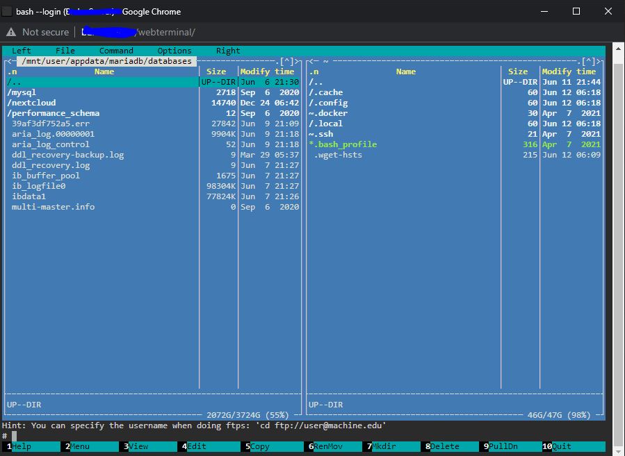

I am continually getting this error in the log in mariadb
cat: /var/run/mysqld/mysqld.pid: No such file or directory
230606 18:04:03 mysqld_safe Logging to '/config/databases/66cb7795ae82.err'.
230606 18:04:03 mysqld_safe Starting mariadbd daemon with databases from /config/databases
Caught SIGTERM signal!
Anyone know what this is or how to fix it? Every search I do turns up nothing at all.
On 8/13/2017 at 9:50 AM, CHBMB said:
OK, so if you're finding the container not starting up and seeing this in the logs repeatedly, (the cause I believe is an unclean shutdown of the container)
170801 17:54:53 mysqld_safe Logging to syslog.
170801 17:54:53 mysqld_safe Starting mysqld daemon with databases from /config/databases
170801 17:54:56 mysqld_safe Logging to syslog.
170801 17:54:56 mysqld_safe Starting mysqld daemon with databases from /config/databases
170801 17:55:00 mysqld_safe Logging to syslog.
170801 17:55:00 mysqld_safe Starting mysqld daemon with databases from /config/databases
170801 17:55:03 mysqld_safe Logging to syslog.
170801 17:55:03 mysqld_safe Starting mysqld daemon with databases from /config/databases
There are two ways to remedy this.  Firstly and my preferred method, is to restore from a backup.  Secondly you can try this by opening a terminal on your Unraid server.
docker exec -it mariadb bash
mv /config/log/ /config/log-old/
exit
docker restart mariadb
I can't promise this second method won't result in some loss of data but it may get you out of a fix.
@CHBMB I am continually getting the same error
230606 18:23:41 mysqld_safe Logging to '/config/databases/66cb7795ae82.err'.
230606 18:23:41 mysqld_safe Starting mariadbd daemon with databases from /config/databases
I can't seem to find any info on the .err  I see you told someone that if they reinstalled mariadb that their nextcloud files should be intact? I just want to make sure before I go that route. Will the data from different accounts all be preserved?
