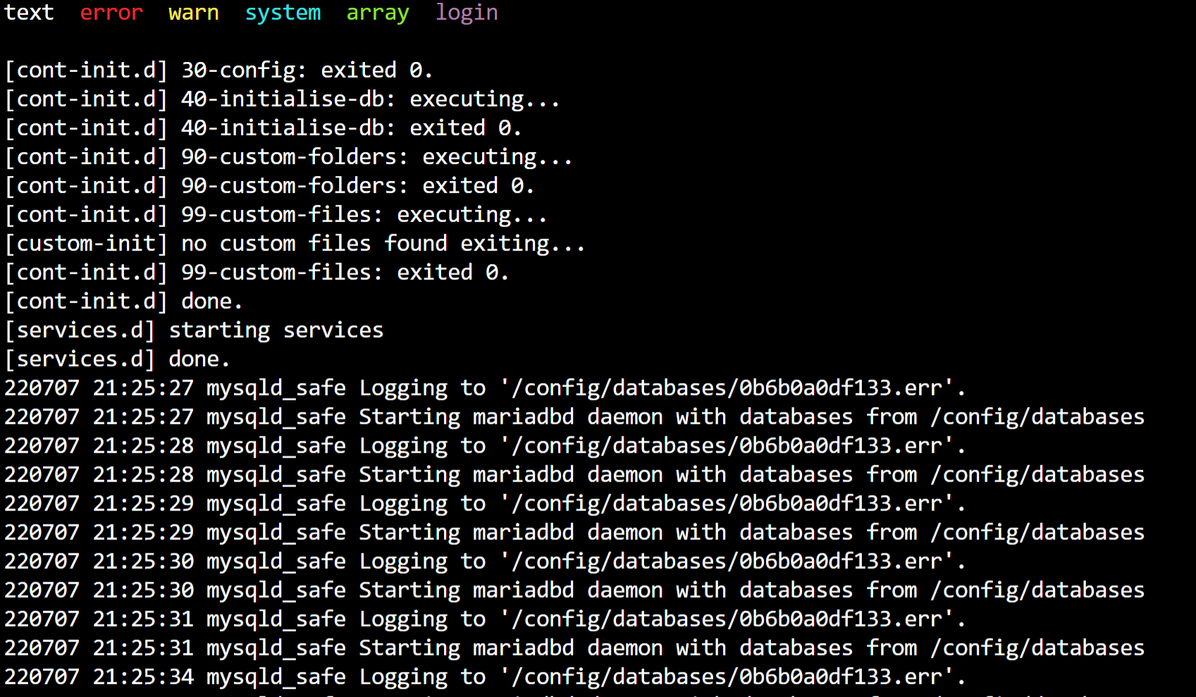

i had a severe crash on my unraid server 3 days ago, docker service kept locking up, and i had to delete docker image and start over.
now everything is back except mariadb.
log from docker:
[cont-init.d] 10-adduser: exited 0.
[cont-init.d] 30-config: executing...
[cont-init.d] 30-config: exited 0.
[cont-init.d] 40-initialise-db: executing...
[cont-init.d] 40-initialise-db: exited 0.
[cont-init.d] 90-custom-folders: executing...
[cont-init.d] 90-custom-folders: exited 0.
[cont-init.d] 99-custom-files: executing...
[custom-init] no custom files found exiting...
[cont-init.d] 99-custom-files: exited 0.
[cont-init.d] done.
[services.d] done.
220519 18:55:56 mysqld_safe Logging to '/config/databases/e8ae576d472a.err'.
220519 18:55:56 mysqld_safe Starting mariadbd daemon with databases from /config/databases
220519 18:55:58 mysqld_safe Logging to '/config/databases/e8ae576d472a.err'.
220519 18:55:58 mysqld_safe Starting mariadbd daemon with databases from /config/databases
220519 18:56:00 mysqld_safe Logging to '/config/databases/e8ae576d472a.err'.
220519 18:56:00 mysqld_safe Starting mariadbd daemon with databases from /config/databases
220519 18:56:02 mysqld_safe Logging to '/config/databases/e8ae576d472a.err'.
220519 18:56:02 mysqld_safe Starting mariadbd daemon with databases from /config/databases
220519 18:56:05 mysqld_safe Logging to '/config/databases/e8ae576d472a.err'.
220519 18:56:05 mysqld_safe Starting mariadbd daemon with databases from /config/databases
220519 18:56:07 mysqld_safe Logging to '/config/databases/e8ae576d472a.err'.
220519 18:56:07 mysqld_safe Starting mariadbd daemon with databases from /config/databases
Caught SIGTERM signal!
cat: /var/run/mysqld/mysqld.pid: No such file or directory
[cont-finish.d] executing container finish scripts...
[cont-finish.d] done.
[s6-finish] waiting for services.
[s6-finish] sending all processes the TERM signal.
[s6-finish] sending all processes the KILL signal and exiting.

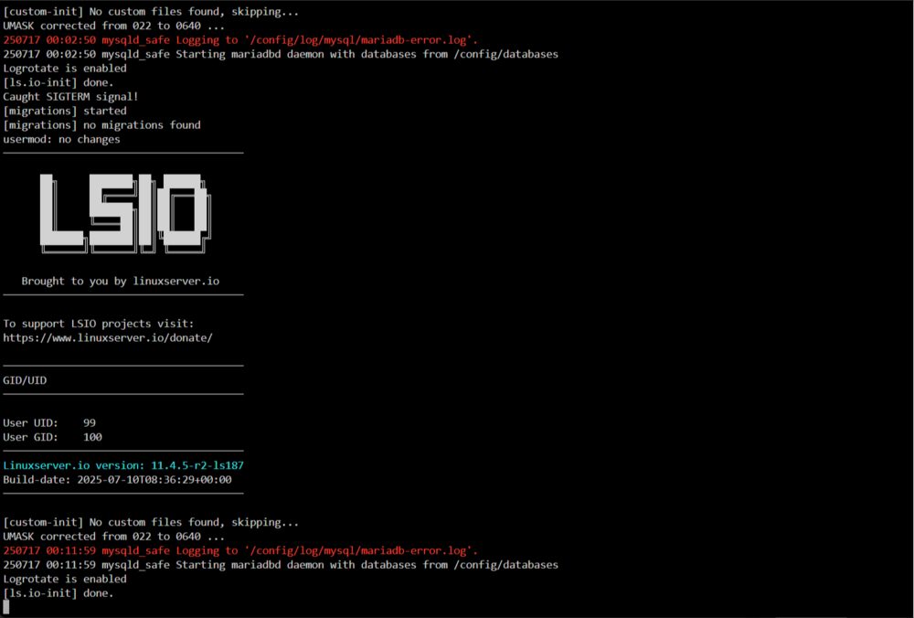

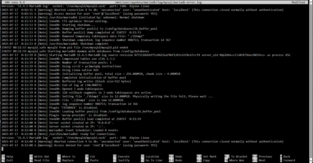

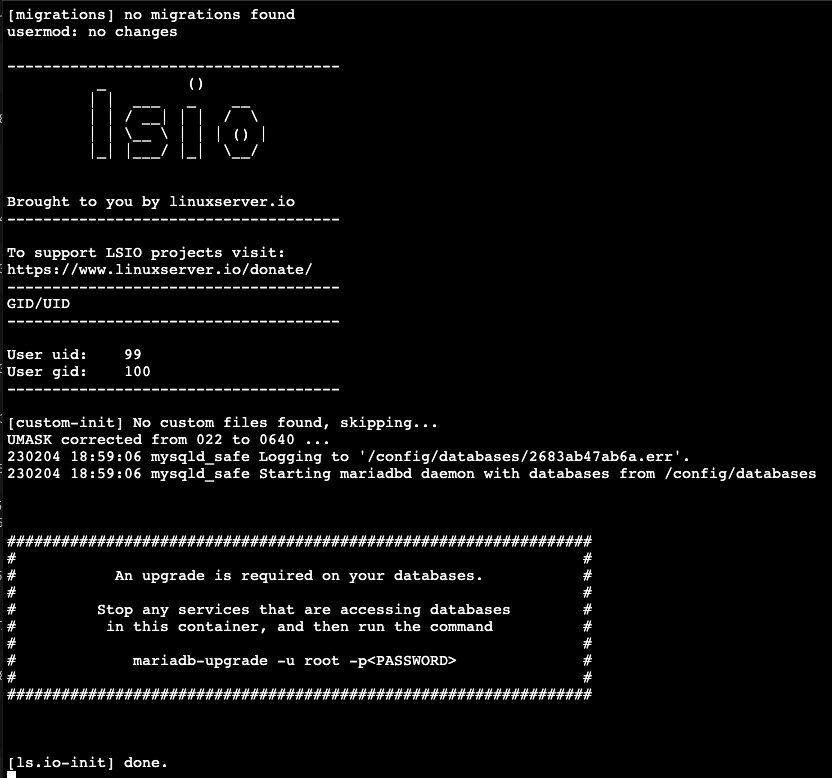

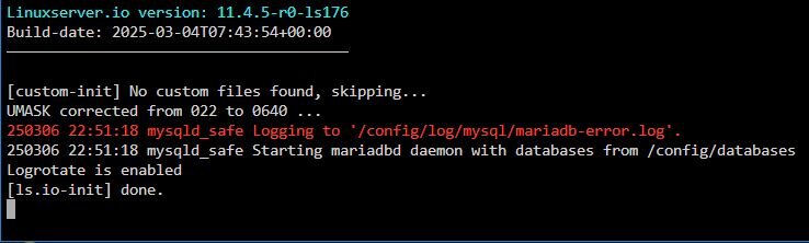

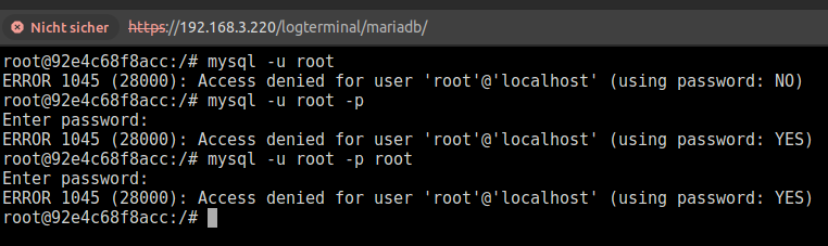

@afsilver I am getting a similar issue as well. I had a recovery and everything is back online except mariadb. Did you ever find a resolution? I'm no noobie, but I haven't been able to resolve this one yet and it would be great to get my dbs back online.
This worked for me: http://raafat.tawasol.net/mysql-crashes-io-error/#:~:text=This means that you have,least the last one is
Edited by live4soccer7
Came here to ask a similar question to others. I have not had any issues with my MariaDB install that I know of but I happened to check the log and noticed the following about a .err file:

Hello, randomly out of the blue I was no longer able to log in to mariadb with root via adminer. I tried with phpmyadmin and via the terminal and also no luck. I also tried to edit the root password on the edit page of the docker container but no luck. Here is the exact error:
ERROR 1045 (28000): Access denied for user 'root'@'localhost' (using password: YES)

Is this container not kept updated with docker? I see this in logs; i have tried to run it but can't seem to figure out the proper way to handle this?
Any help?
Any help?
406264173_ScreenShot2023-02-05at9_06_11AM.thumb.png.6cb9b52d09ac017e842a7afcbd9959f6.png
Yea, seeing the same thing and wondering if any action is needed on my part?
Yes
Stop all of your containers using mysql, then open a mariadb console, then enter the following, followed by your password.
mysql_upgrade -u root -p
