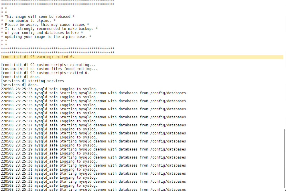

I am starting to hate MariaDB on Unraid (or I am just an idiot)...
Now after every MariaDB somehow my Databases are not working anymore.
Upraded today to the latest version:
220130 08:27:41 mysqld_safe Logging to '/config/databases/d6db1815057e.err'.
220130 08:27:41 mysqld_safe Starting mariadbd daemon with databases from /config/databases
UMASK must be a 3-digit mode with an additional leading 0 to indicate octal.
The first digit will be corrected to 6, the others may be 0, 2, 4, or 6.
UMASK corrected from 022 to 0640 ...
220130 08:27:42 mysqld_safe Logging to '/config/databases/d6db1815057e.err'.
220130 08:27:42 mysqld_safe Starting mariadbd daemon with dat
220130 08:31:57 mysqld_safe Starting mariadbd daemon with databases from /config/databases
2022-01-30  8:31:57 0 [Note] /usr/bin/mariadbd (mysqld 10.5.13-MariaDB-log) starting as process 30017 ...

2022-01-30  8:31:57 0 [Note] Found 1 prepared transaction(s) in InnoDB
2022-01-30  8:31:57 0 [ERROR] Found 1 prepared transactions! It means that mysqld was not shut down properly last time and critical recovery information (last binlog or tc.log file) was manually deleted after a crash. You have to start mysqld with --tc-heuristic-recover switch to commit or rollback pending transactions.
2022-01-30  8:31:57 0 [ERROR] Aborting
220130 08:31:58 mysqld_safe mysqld from pid file /var/run/mysqld/mysqld.pid ended
Try increasing the timeout (or alternatively stop the container before upgrading).
I guess for stopping the container before upgrading is too late.
The question is how I can recover the broken DB now.

my mariadb container seems to have a problem which i am not able to locate and solve.
I noticed because Nextcloud shows "internal server error" and Photoprism does not launch. Both containers are the only one using mariadb databases.
MariaDB Log window sows:
I already found and tried to change the repository to linuxserver/mariadb:110.4.21mariabionic-ls31
it diidnt help.
i hope you can get me on the right path as it was a lot of work to re setup everything for someone with my knowledge level :)
thanks!
