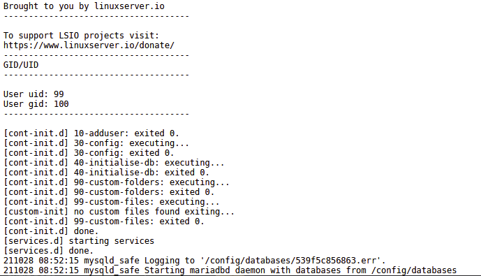

Out of curiosity, do you have in your logs:
211004 10:30:59 mysqld_safe Logging to '/config/databases/90d1ec1b4a9c.err'.
211004 10:30:59 mysqld_safe Starting mariadbd daemon with databases from /config/databases
I have it in mine, but everything works fine (or at least seems to).
Just wondering if I do the above 'downgrade, command, upgrade fix' if it will fix that problem, too.
Cheers.

I have that in mine, but I think it's normal.    Now it appears only once at the end of the docker log.

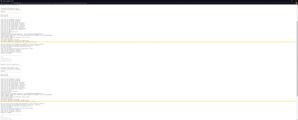

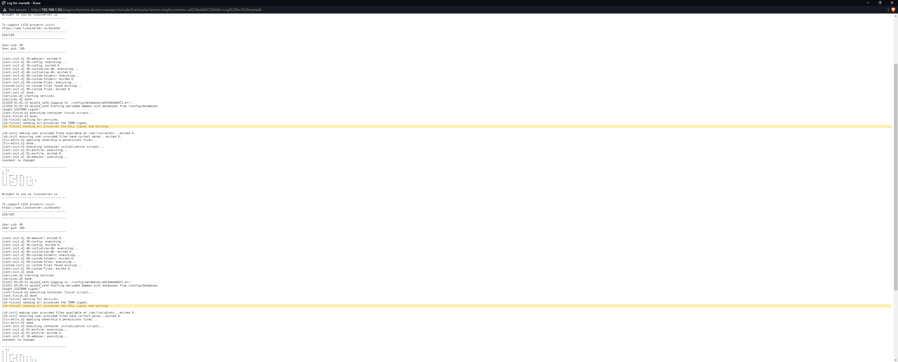

At some point coincident with the latest update to the MariaDB container, I've had an issue where the container will not allow multiple clients to connect to the Kodi databases.  I've attached the log, but basically if one client is accessing the database, it will refuse to let another connect until I restart the container.  I've made no configuration changes other than attempting the downgrade/upgrade to latest procedure on page 17.
Any ideas?
Thanks!
-P
marialog.txt

I have the same issue.
Why does MariaDB keep rebooting on its own? It's kicking my Ghost blog offline all the time...
I thought I'd fixed this issue but no, still occurring so add me to the list of people with this issue and Kodi.

Today I updated the MariaDB Docker and now it is not starting anymore.
the err-log shows the following:
2021-10-23 17:53:53 0 [ERROR] Found 1 prepared transactions! It means that mysqld was not shut down properly last time and critical recovery information (last binlog or tc.log file) was manually deleted after a crash. You have to start mysqld with --tc-heuristic-recover switch to commit or rollback pending transactions.
2021-10-23 17:53:53 0 [ERROR] Aborting
any ideas?

my mariaDB is stuck in a boot loop now, is anyone else having this problem after the lastest update?
211026 11:00:22 mysqld_safe Starting mariadbd daemon with databases from /config/databases

Unfortunatley nothing helped for me.
I have completely removed MariaDB-Docker and reinstalled.
A fresh installation is working. But when I copy/paste "databases"-Directory, then its failing again.
UMASK must be a 3-digit mode with an additional leading 0 to indicate octal.
The first digit will be corrected to 6, the others may be 0, 2, 4, or 6.
UMASK corrected from 022 to 0640 ...
211029 11:27:36 mysqld_safe Logging to '/config/databases/92ecc8717197.err'.
211029 11:27:36 mysqld_safe Starting mariadbd daemon with databases from /config/databases
211029 11:29:59 mysqld_safe Starting mariadbd daemon with databases from /config/databases
2021-10-29 11:29:59 0 [Note] /usr/bin/mariadbd (mysqld 10.5.12-MariaDB-log) starting as process 4723 ...
2021-10-29 11:29:59 0 [Note] InnoDB: Uses event mutexes
2021-10-29 11:29:59 0 [Note] InnoDB: Compressed tables use zlib 1.2.11
2021-10-29 11:29:59 0 [Note] InnoDB: Number of pools: 1
2021-10-29 11:29:59 0 [Note] InnoDB: Using crc32 + pclmulqdq instructions
2021-10-29 11:29:59 0 [Note] mariadbd: O_TMPFILE is not supported on /var/tmp (disabling future attempts)
2021-10-29 11:29:59 0 [Note] InnoDB: Using Linux native AIO
2021-10-29 11:29:59 0 [Note] InnoDB: Initializing buffer pool, total size = 268435456, chunk size = 134217728
2021-10-29 11:29:59 0 [Note] InnoDB: Completed initialization of buffer pool
2021-10-29 11:29:59 0 [Note] InnoDB: Transaction 209762720 was in the XA prepared state.
2021-10-29 11:29:59 0 [Note] InnoDB: 1 transaction(s) which must be rolled back or cleaned up in total 0 row operations to undo
2021-10-29 11:29:59 0 [Note] InnoDB: Trx id counter is 209762721
2021-10-29 11:29:59 0 [Note] InnoDB: 128 rollback segments are active.
2021-10-29 11:29:59 0 [Note] InnoDB: Starting in background the rollback of recovered transactions
2021-10-29 11:29:59 0 [Note] InnoDB: Rollback of non-prepared transactions completed
2021-10-29 11:29:59 0 [Note] InnoDB: Creating shared tablespace for temporary tables
2021-10-29 11:29:59 0 [Note] InnoDB: Setting file './ibtmp1' size to 12 MB. Physically writing the file full; Please wait ...
2021-10-29 11:29:59 0 [Note] InnoDB: File './ibtmp1' size is now 12 MB.
2021-10-29 11:29:59 0 [Note] InnoDB: 10.5.12 started; log sequence number 402194885721; transaction id 209762722
2021-10-29 11:29:59 0 [Note] Plugin 'FEEDBACK' is disabled.
2021-10-29 11:29:59 0 [Note] InnoDB: Loading buffer pool(s) from /config/databases/ib_buffer_pool
2021-10-29 11:29:59 0 [Note] InnoDB: Buffer pool(s) load completed at 211029 11:29:59
2021-10-29 11:29:59 0 [Note] InnoDB: Starting recovery for XA transactions...
2021-10-29 11:29:59 0 [Note] InnoDB: Transaction 209762720 in prepared state after recovery
2021-10-29 11:29:59 0 [Note] InnoDB: Transaction contains changes to 4 rows
2021-10-29 11:29:59 0 [Note] InnoDB: 1 transactions in prepared state after recovery
2021-10-29 11:29:59 0 [Note] Found 1 prepared transaction(s) in InnoDB
2021-10-29 11:29:59 0 [ERROR] Found 1 prepared transactions! It means that mysqld was not shut down properly last time and critical recovery information (last binlog or tc.log file) was manually deleted after a crash. You have to start mysqld with --tc-heuristic-recover switch to commit or rollback pending transactions.
2021-10-29 11:29:59 0 [ERROR] Aborting
211029 11:29:59 mysqld_safe mysqld from pid file /var/run/mysqld/mysqld.pid ended
